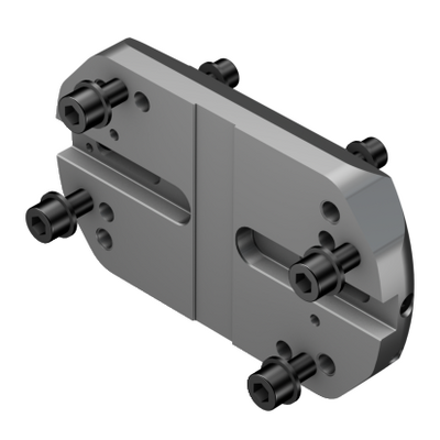

A33-R822XLS17-LJ030
A33-R822XLS17-LJ030
A33-R822XLS17-LJ030
Bridge to CoroBore® XL tool body
Out of stock
ISO: A33-R822XLS17-LJ030
Material Id: 6872869
EAN: 7323220289479
ANSI: A33-R822XLS17-LJ030

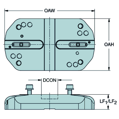

Minimum cutting diameter
(DCN)
148 mm
Maximum cutting diameter
(DCX)
200 mm
Maximum adjustment limit
(ADJLX)
12.5 mm
Boring arbor -2 key drives -metric: 33
33 mm
Connection - workpiece side
(ADINTWS)
Boring Slide -size S17FR
(LF_1)
30 mm
Functional width
(WF_1)
35.5 mm
30 mm
Overall height
(OAH)
104 mm
Overall width
(OAW)
130 mm
Body material
Aluminum
0.94 kg
