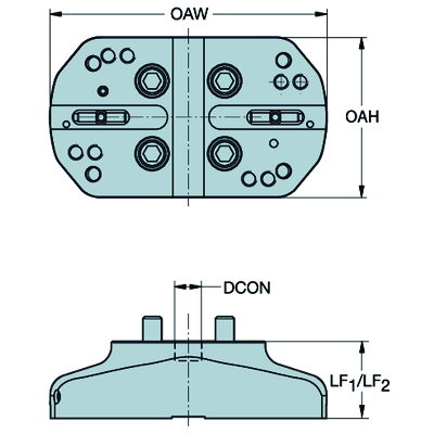

Minimum cutting diameter
(DCN)
148 mm
Maximum cutting diameter
(DCX)
200 mm
Arbor -ISO 6462 -C (4 bolts) -metric: 40S
40 mm
Connection - workpiece side
(ADINTWS)
Boring Slide -size S17FR
(LF_1)
50 mm
Functional width
(WF_1)
35.5 mm
50 mm
Overall height
(OAH)
104 mm
Overall width
(OAW)
130 mm
Body material
Aluminum
1.477 kg
