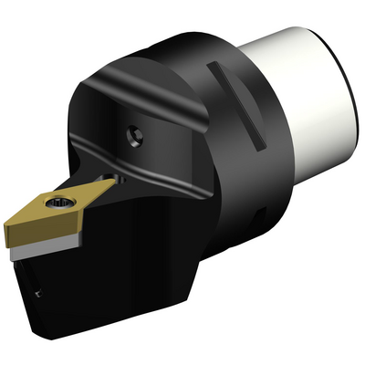

CoroTurn® 107, cutting unit for turning

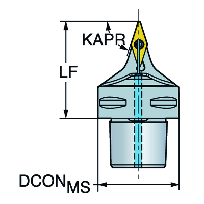

Tool cutting edge angle
72.5 °
(KAPR_2)
72.5 °
Lead angle
17.5 °
Clamping type code
Insert type
VBMT 160408/ VCMT 160408
Maximum ramping angle
70 °
Minimum bore diameter
(DMIN_2)
145 mm
Workpiece side body angle
Machine side body angle
Maximum overhang
55 mm
Coolant exit style
Coolant pressure
150 bar
40 mm
55 mm
Functional width
0.6 mm
Functional height
Orthogonal rake angle
Inclination angle
3 Nm
Body material
Steel
0.31 kg
Master insert identification
VBMT 16 04 08
79 mm
Insert seat - metric
16
3/8
2/20/20
