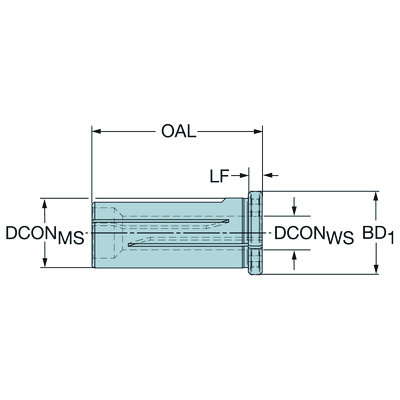

Cylindrical sleeve with Easy-Fix positioning
ISO: EFF-25-10
Material Id: 8184247
EAN: 7323226497106
ANSI: EFF-25-10
Cylindrical shank (ISO9766 drill shank with flange) -metric: 25
Connection - workpiece side
(ADINTWS)
Cylindrical clamping (sleeve) -metric: 10
Sealing property
(SEAL)
Yes
Location aid property
(LOCAP)
Yes
Coolant exit style
axial concentric on circle
Coolant pressure
150 bar
25 mm
Connection diameter workpiece side
(DCONWS)
10 mm
5 mm
61 mm
Body diameter
(BD)
30 mm
Body length
(LB)
5 mm
Body half taper angle
(BHTA)
0.1736 kg
