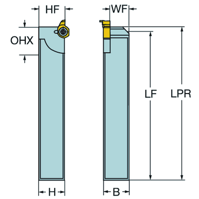

Connection - workpiece side
(ADINTWS)
CoroCut MB -size 09
Maximum overhang
20 mm
Coolant exit style
Connection diameter workpiece side
(DCONWS)
9 mm
Shank width
25 mm
Shank height
25 mm
Protruding length
(LPR)
150 mm
(LF_1)
145.5 mm
Functional width
(WF_1)
28.1 mm
Functional height
(HF_1)
25 mm
150 mm
3 Nm
Body material
Steel
0.752 kg
