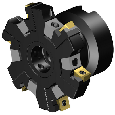

CoroMill® 331, adjustable cutter for half side and back face milling
Specific representation
Made-to-order
ISO: R331.52C-080Q27FML
Material Id: 7843386
EAN: 7323224953505
ANSI: R331.52C-080Q27FML
Cutting diameter
80 mm
Cutting depth maximum
20.3 mm
Working engagement ratio maximum
(AERMX_BFW)
0.25
Clamping type code
Insert type
CoroMill 331 -size 08 (N/L331.1A-08RE0.20-1.54)
(ZEFP)
6
Arbor -ISO 6462 -A (hexagon socket head cap screw) -metric: 27
Coolant pressure
80 bar
27 mm
Hub diameter
(DHUB)
51 mm
Standard number
(STDNO)
ISO6462
Standard letter
(STDLET)
A
38 mm
1.4 Nm
Rotational speed maximum
18,100 1/min
0.587 kg
Body diameter
(BD)
77.6 mm
Body length
(LB)
11.5 mm
38 mm
