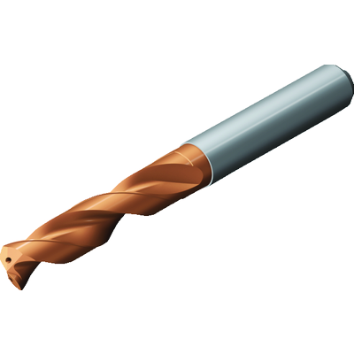

Drill
Solid twist drill
Solid drill with symmetrical point
R846-1400-30-A1A 1220
CoroDrill® Delta-C, solid carbide drill
Being replaced by
860.1-1400-040A1-SM 1210
Available within a week
Different geometry and grade vs. the original one – Please check feed.
ISO: R846-1400-30-A1A 1220
Material Id: 6256423
EAN: 26256423
ANSI: R846-1400-30-A1A 1220
Cutting diameter
14 mm
14 mm
Usable length
44.4 mm
Achievable hole tolerance
(TCHA)
H9
Usable length diameter ratio
(ULDR)
3.1714
Orthogonal rake angle
20.44 °
Face effective cutt edge count
(ZEFF)
Cylindrical shank (DIN6535-HA) -metric: 14
Connection diameter tolerance
(TCDCON)
h6
1220
PVD TiAlN
Shank standard group
(BSG)
DIN 6537 K
Chip breaker
SM
Coolant pressure
20 bar
Point angle
(SIG)
140 °
Point length
(PL)
2.4 mm
107 mm
104.6 mm
Chip flute length
(LCF)
60 mm
Rotational speed maximum
1,137 1/min
0.1665 kg
10/30/19
12.2
