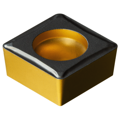

CoroTurn® 107, insert for turning
Package quantity: 10
ISO: SCMT 09 T3 08-UF 4425
Material Id: 7860864
EAN: 7323225048323
ANSI: SCMT 3(2.5)2-UF 4425
Start values
75 deg
P2.1.Z.AN
Hardness: 175 HB
0.4 mm (0.2 - 2)
0.12 mm/r (0.06 - 0.29)
0.1 mm/r (0.05 - 0.25)
430 m/min (465 - 350)
K2.2.C.UT
Hardness: 245 HB
0.4 mm (0.2 - 2)
265 m/min (285 - 200)
Chip breaker
UF
Operation type
finishing
Fixing hole diameter
4.4 mm
Insert size and shape
SC09T3
Cutting edge count
Inscribed circle diameter
9.525 mm
Insert shape code
Square
Cutting edge effective length
8.725 mm
Corner radius
0.7938 mm
4425
CVD TiCN+Al2O3+TiN
Insert thickness
3.9688 mm
Clearance angle major
7 °
0.0029 kg
Insert seat - metric
09
3/8
