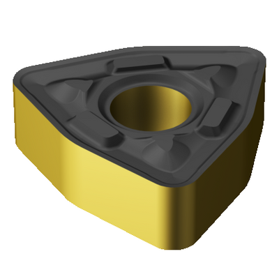

WNMG 08 04 12-MR 2220content_copy
Being replaced by WNMG 08 04 12-MR 2515
Package quantity: 10
ISO: WNMG 08 04 12-MR 2220file_copy
Material Id: 7231507file_copy
EAN: 7323221715076file_copy
ANSI: WNMG 433-MR 2220file_copy
Start values  (KAPR  95 deg )
M1.0.Z.AQ, Hardness: 200 HB
ap 2.5  mm   (2 - 4)
fn 0.35  mm/r   (0.15 - 0.6)
hex 0.35  mm/r   (0.15 - 0.6)
vc 180  m/min   (255 - 130)

Chip breaker(CBMD)info
MRSearch Icon
Operation type (CTPT)info
roughingSearch Icon
Fixing hole diameter(D1)info
5.156 mmSearch Icon
WN0804Search Icon
Cutting edge count(CEDC)info
6Search Icon
12.7 mmSearch Icon
Insert shape code(SC)info
Trigon 80Search Icon
7.4873 mmSearch Icon
Corner radius (RE)info
1.1906 mmSearch Icon
Hand (HAND)info
NeutralSearch Icon
Grade (GRADE)info
2220Search Icon
Substrate(SUBSTRATE)info
HCSearch Icon
Coating(COATING)info
CVD TiCN+Al2O3+TiNSearch Icon
Insert thickness(S)info
4.7625 mmSearch Icon
Clearance angle major(AN)info
Weight of item(WT)info
0.0084 kgSearch Icon
Insert seat - metric(SSC_M)info
08Search Icon
1/2Search Icon
2/19/17Search Icon
17.1Search Icon
