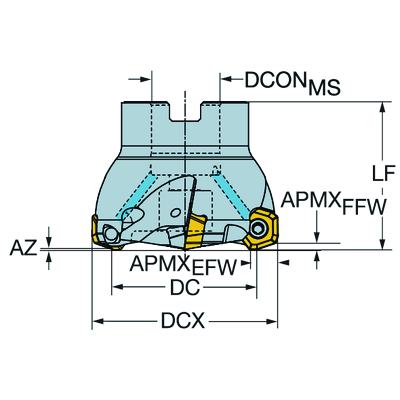

CoroMill® 419 face milling cutter
Specific representation
ISO: A419-051R19-14M
Material Id: 6289908
EAN: 26289908
ANSI: A419-051R19-14M
Tool cutting edge angle
(KAPR)
19 °
Cutting diameter
36.1 mm
Maximum cutting diameter
(DCX)
50.8 mm
Cutting item count
(CICT_2)
Clamping type code
Part 2 of cutting item interface identifiers
(CUTINT_MASTER_2)
CoroMill 419 -size 1405 (419R-1405)
Depth of cut maximum
(APMX_EFW)
8 mm
(APMX_FFW)
2 mm
Maximum ramping angle
8 °
Maximum plunge depth
(AZ)
2 mm
Cutting pitch differential
(CPDF)
Yes
(ZEFP)
Arbor -ISO 6462 -A (hexagon socket head cap screw) -inch: 3/4
Coolant pressure
10 bar
19.05 mm
Standard number
(STDNO)
ISO6462
Standard letter
(STDLET)
A
44.45 mm
Radial rake angle
(GAMF)
6.1051 °
Axial rake angle
(GAMP)
8.5116 °
5 Nm
Body material
Steel
Rotational speed maximum
17,300 1/min
0.332 kg
44.45 mm
10/20/12
