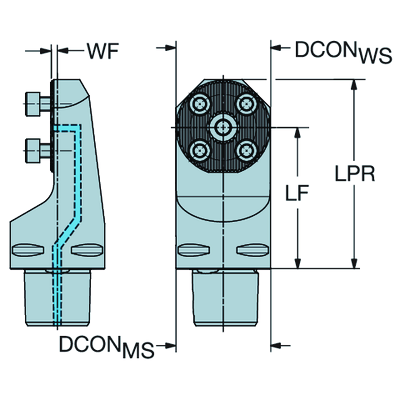

Connection - workpiece side (ADINTWS)info
SL (screw mounted) -angled -size 32Search Icon
Maximum overhang (OHX)info
60 mmSearch Icon
Hand (HAND)info
Coolant entry style(CNSC)info
Coolant exit style(CXSC)info
Coolant pressure(CP)info
150 barSearch Icon
Connection diameter machine side(DCONMS)info
40 mmSearch Icon
Connection diameter workpiece side(DCONWS)info
32 mmSearch Icon
Protruding length(LPR)info
76.3 mmSearch Icon
Functional length(LF_1)info
60 mmSearch Icon
Functional width(WF_1)info
6.5 mmSearch Icon
Functional height(HF_1)info
Overall length(OAL)info
100.3 mmSearch Icon
