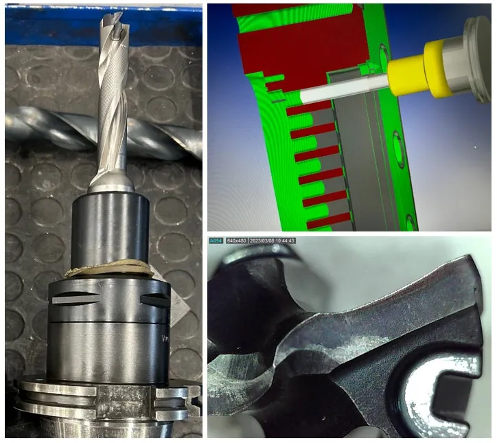

CoroDrill® DE10
The exchangeable-tip drill for high-volume hole making
Outperformed competitor in stainless steel
+57%
Productivity
+43%
Tool life
Country:Italy
Component:Plate
Material:M1.0.Z.AQ, AISI316L, austenitic stainless steel
Operation:52 mm, one part through hole and one part blind hole
Machine:Doosan NHP6300
Coolant:Emulsion 8%, 70 bar (1015 PSI)
Challenge: Due to the cost of the component, reliability and repeatability are the most important factors.
Result: CoroDrill® DE10 had very good sound level and chip form was like the competitor. The hole surface quality was good and the hole diameter was in line with expectations. Even longer tool life is expected with grade GC2334.
CompetitorCoroDrill® DE10
Tool-DE10-D1600-160L20-5
Drill tip-DE10-1650-160-M5 4334
vc, m/min4055
n, rpm7721060
fn, mm0.140.16
vf, mm/min108170
Tool life, holes126180
Tool life, m6.69.3
Tool life, minutes6155

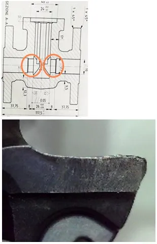

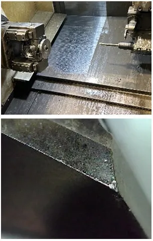

Unmatched performance in difficult application
+89%
Productivity
Country:Italy
Component:Valve
Material:M3.2.Z.AQ, machined super duplex stainless steel
Operation:
Through hole, 2×10 mm deep,
irregular exit
Machine:Doosan GT3100
Coolant:Emulsion 10%
Challenge: The customer has problems with long chips wrapping around the drill. Uses low entering feed in steps and has poor productivity and tool life.
Result: CoroDrill® DE10 has improved productivity and chip breakage, with no chips wrapped around the drill. When tested with the same cutting parameters, CoroDrill® DE10 doubled the tool life. Even longer tool life is expected with grade GC2334.
Competitor, 10 pcs
CoroDrill® DE10, 30 pcs
Tool-DE10-D1700-170L20-5
Drill tip-DE10-1710-170-M5 4334
vc, m/min4350
n, rpm800930
fn, mm0.08–0.060.15–0.1
vf, mm/min64-48140–93
Tool life, holes6060
Tool life, m0.30.3
Tool life, minutes10.25.4

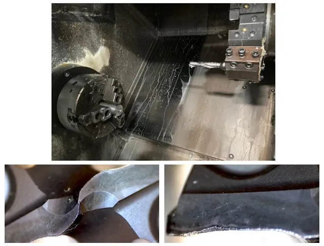

Excellent performance in lathe application
+49%
Productivity
+37%
Tool life
Country:India
Component:Pin
Material:P2.1.Z.AN, 17Cr3, alloyed steel
Operation:84 mm drilling in lathe
Machine:RoboTurn FAR
Coolant:Emulsion
Challenge: Chip breaking and chip control are very important. Chips should not obstruct the working of the conveyor and gantry. Competitor chips are not consistent, and snarls of varied lengths are reported.
Result: CoroDrill® DE10 provided increased productivity and tool life, with good corner security and chips.
Drill tip-DE10-1750-170-M5 4334
vc, m/min7197
n, rpm13001765
fn, mm0.20.22
vf, mm/min260388
Tool life, holes12001650
Tool life, m101138
Tool life, minutes388357
