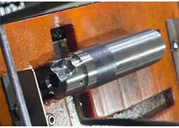

Customer case
+225%
Tool life increase
+85%
Productivity increase
Component:Automotive, steering gear
Material:Low alloy steel,  P2.1.Z.AN (28–30HRc)
Operation:Blind hole drilling
Hole size:6.0 mm (0.236 inch)
Machine:Turning center, lathe (Tsugami)
Coolant:Internal emulsion 8%, 10 bar (145 PSI)
Challenge: Increase productivity and tool life against a low-cost local competitor.
Result: CoroDrill® Dura 462 outperformed the current solution with a productivity increase of 85% while achieving a tool life of more than double.
Local competitorCoroDrill® Dura 462, same dataCoroDrill® Dura 462, improved data

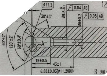

Customer case
+380%
Tool life increase
+67%
Hole size:9.2 mm (0.362 inch)
Challenge: Increase productivity and tool life against a local competitor.
Result: CoroDrill® Dura 462 outperformed the current solution, delivering a 67% increase in productivity while achieving a tool life nearly four times longer than the existing solution.
Additional savings: less tool inventory and fewer tool changes.
Local competitor​CoroDrill® Dura 462, same data ​CoroDrill® Dura 462, improved data ​

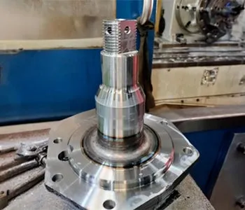

Customer case
+20%
Tool life increase
Component:Automotive, steering stem
Hole size:8.8 mm (0.346 inch)
Machine:Vertical machining center
Coolant:
External emulsion
(Old machines with high spindle run-out. Non-through coolant setup)
Challenge: Increase tool life and lower the cost per hole.
Result: At the initial test with CoroDrill® Dura 462, a 20% tool life increase was achieved compared to the competitor. The customer felt confident that further improvements could decrease the cost per hole even more.
CompetitorCoroDrill® Dura 462

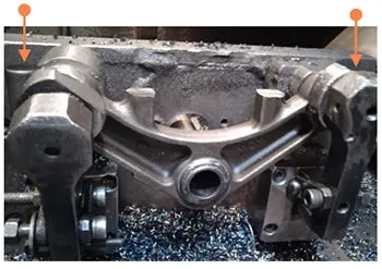

Customer case
+110%
+36%
Tool life increase
Component:Axle arm (steering knuckle)
Material:P2.2.Z.AN (40Cr4 / 42CrMo) 240HB
Operation:Through and cross hole drilling
Hole size:7.0 mm (0.276 inch)
Machine:Vertical machining center (LMW- JV 100-BT40)
Challenge: To reduce cost per component while safeguarding process security in cross-hole drilling.
Result: CoroDrill® Dura 462 delivered a 110% increase in productivity and a 36% extension in tool life.
CoroDrill® 460 -XMCoroDrill® Dura 462
