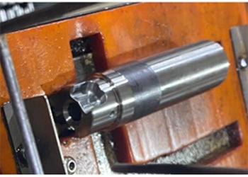

CoroDrill® Dura 462
Versatile solid carbide drills for short-hole drilling in multi-material applications

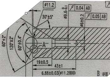

Component:Automotive, steering gear
Material:Low alloy steel,  P2.1.Z.AN (28–30HRc)
Operation:Blind hole drilling
Hole size:9.2 mm (0.362 inch)
Machine:Turning center, lathe (Tsugami)
Coolant:Internal emulsion 8%, 10 bar (145 PSI)
Challenge: Increase productivity and tool life against a local competitor.
Result: CoroDrill® Dura 462 outperformed the current solution, delivering a 67% increase in productivity while achieving a tool life nearly four times longer than the existing solution.
Additional savings: less tool inventory and fewer tool changes.
Local competitor​CoroDrill® Dura 462, same data ​CoroDrill® Dura 462, improved data ​
Tool​
9.2 mm
​(0.362 inch)​
462.1-0920-046A1-XM X2BM​462.1-0920-046A1-XM X2BM​
n, rpm​3000​3000​3000​
vc, m/min (ft/min)​87 (285)​87 (285) ​87 (285)​
fn, mm/rev (in/rev) ​0.12 (0.005)​0.12 (0.005)​0.2 (0.008)​
Hole depth, mm (inch) ​19 (0.748)​19 (0.748)​19 (0.748)​
Tool life, no. of holes120013404577

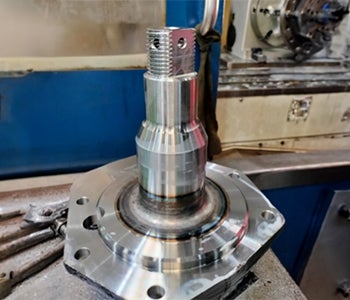

Component:Automotive, steering stem
Hole size:8.8 mm (0.346 inch)
Machine:Vertical machining center
Coolant:
External emulsion
(Old machines with high spindle run-out. Non-through coolant setup)
Challenge: Increase tool life and lower the cost per hole.
Result: At the initial test with CoroDrill® Dura 462, a 20% tool life increase was achieved compared to the competitor. The customer felt confident that further improvements could decrease the cost per hole even more.
CompetitorCoroDrill® Dura 462

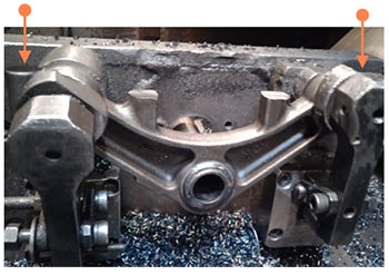

Component:Axle arm (steering knuckle)
Material:P2.2.Z.AN (40Cr4 / 42CrMo) 240HB
Operation:Through and cross hole drilling
Hole size:7.0 mm (0.276 inch)
Machine:Vertical machining center (LMW- JV 100-BT40)
Challenge: To reduce cost per component while safeguarding process security in cross-hole drilling.
Result: CoroDrill® Dura 462 delivered a 110% increase in productivity and a 36% extension in tool life.
CoroDrill® 460 -XMCoroDrill® Dura 462
Tool460.1-0700-035A1-XM GC34462.1-0700-035A1-XM- X2BM
n, rpm28003180
vc, m/min (ft/min)61.5 (202)70 (230)
fn, mm/rev (in/rev)0.07 (0.003)0.13 (0.005)
Hole depth, mm (inch)32 (1.26)32 (1.26)
Tool life, no. of holes220300
