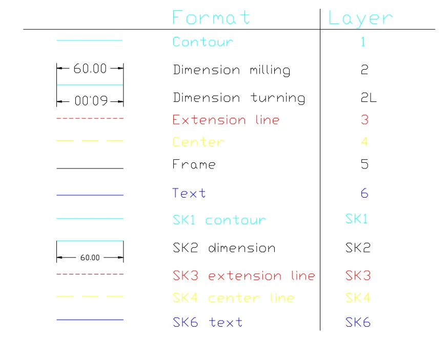

Layer structure
2D drawings used in the CoroPlus® ToolLibrary must adhere to the layer structure defined by ISO13399 Part 70. While loading the drawings, the software applies the defined colours, fonts and line types. For the tool assemblies, a set of layers and their SK pendants have an important influence. In the following table, you can find a list of layers that are usually used for item drawings:
Contour
1
Cyan
0,255,255
Visible external outline for the tool assembly and item drawing
Dimension
White
255,255,255
Dimension of the tool assembly and item drawings
Help line
3
Red
255,0,0
Help geometries of tool assembly and item drawings
Center line
Yellow
255,255,0
Center line only for the tool assembly
Frame
5
White
255,255,255
Drawing and text elements of the item or tool assembly sheet
Text
6
Blue
0,0,255
Text elements of the item or tool assembly drawings and the hatch of the indexable inserts
Hatch
7
Blue
0,0,255
Hatch of the tool assembly and item drawing
SK1 Contour
SK1
Cyan
0,255,255
Outline elements only for items
SK2 Dimension
SK2
White
255,255,255
Dimension only visible in single items
SK3 Help line
SK3
Red
255,0,0
Help geometries only for items
SK4 Center line
SK4
Yellow
255,255,0
Center line only visible in single items
SK6 Text
SK6
Blue
0,0,255
Label of the item
SK7 Hatch
SK7
Blue
0,0,255
Hatch of the item
The line types, descriptions and colours of the single layers are shown in the following image:

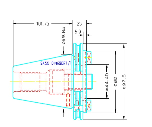

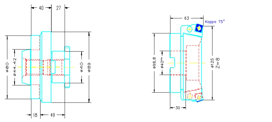

Item view
The example shows three items which are part of a milling tool assembly. On the item level most of the layers are presented.

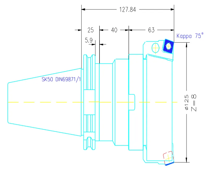

Tool assembly view
Some of the layers are cut off, to make the tool assembly drawing look clean and understandable.
