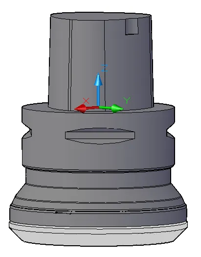

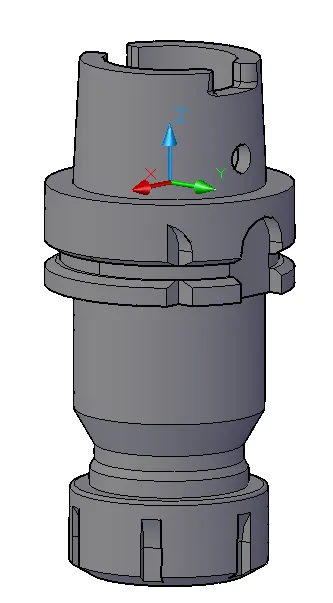

Reference point
Adaptive items
The reference point is most of the time located at the plane gauge for adaptive items.
Cutting items
For cutting items with no fixed stop, the reference point is at the end.
For cutting items with a fixed stop, the reference point is on the stop surface.

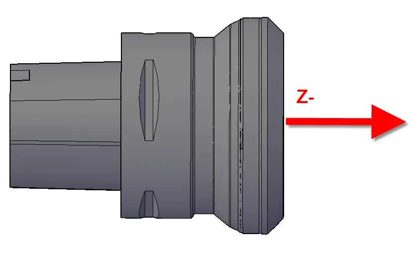

Orientation of items

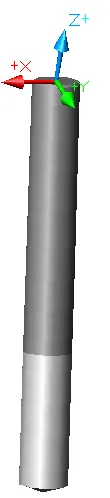

The orientation in 3D is defined as Z-axis negative to the workpiece.

If you want to use the models in simulation systems, you must differentiate among the cutting (CUT) and non-cutting parts (NOCUT) of an item. The differentiation is done with the colour attributes in the STEP-File. They are indicated via RGB values in an area from 0 to 1 (%) (1st parameter=red, 2nd parameter=green, 3rd parameter=blue). You can mostly find this information in the files as a percentage value, e.g., COLOUR_RGB ('', 1., 0.75, 0.)
CUT part (color light grey)
0.8
0.8
0.8
204
204
204
NOCUT part (color grey)
0.5
0.5
0.5
128
128
128

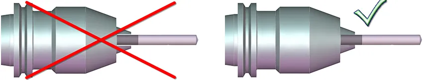

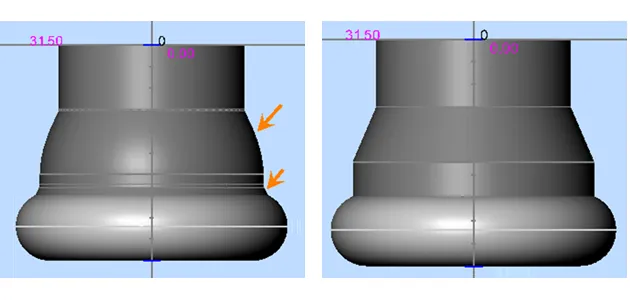

Level of detail for 3D solids
  • Only simple models rotated: only cylinder, no chip space, no indexable inserts, no internal coolant, no “inner life”. Close the clamping chuck at the front. Otherwise, the drill is dangling in the air.

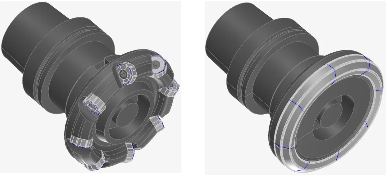

  • Avoid radiuses, arcs and too many cylinders, which are not collision relevant. This makes simulation slow.
  • Watch for items that are plugged into each other to ensure that the distance between them is not too great.
  • Avoid gaps in the assembling area to get a volume model and not a surface model.
  • For cutting tools: At least two bodies are necessary to differentiate between CUT/NOCUT.
  • For standing tools: Planar cutting surfaces are necessary for indexable inserts.

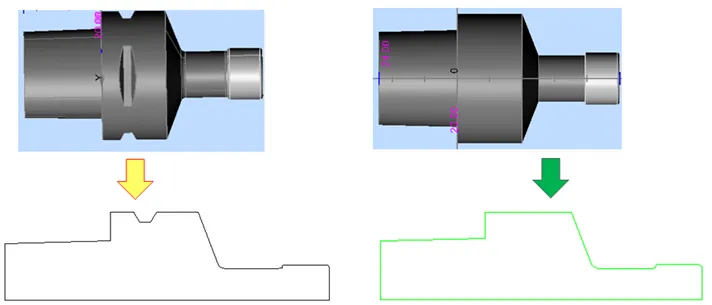

  • The resulting slice curves must consist of lines and arcs.
The Coromant Capto® shank (left image) is very detailed and might lead to a different shape if the contour is needed for the CAM Interface.
The cutter body consists of many arcs and few little lines. Therefore, for usage in simulation, a simplified geometry shown on the right is much better.
