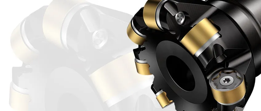

M612 – Face milling cutter for machining stainless steel turbo housings
The M612 face milling cutter is developed exclusively for machining stainless steel turbo exhaust housings. The positive geometry and edge-line quality ensure a reliable performance and an increased number of components per insert.
Features and benefits
  • For challenging roughing operations
  • Positive geometry provides smooth cutting action, which lowers the power consumption and eliminates vibrations
  • 12 cutting edges, six on both sides, for reduced cost per part
  • Round inserts for increased flexibility and a high metal removal rate
  • Shim for extra protection of the cutter body
  • Not necessary to completely remove the screw in order to index another insert cutting edge.
  • A visual dimple has been machined to a rapid check on the edge position.
Application
  • Face and interpolation milling
  • Maximum depth of cut 3 mm (0.118 inch) to keep positive cutting action
The positive geometry and edge-line quality ensure a reliable performance and a high number of components per edge.
