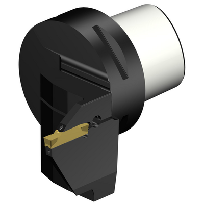

C6-RF123J25CE-175Bcontent_copy
C6-RF123J25CE-175B
Specific representation
Being replaced by C2A-CC6-RFJ18B-175CB
Different clamping system vs the original product but compatible with original inserts
ISO: C6-RF123J25CE-175Bfile_copy
Material Id: 6799008file_copy
EAN: 26799008file_copy
ANSI: C6-RF123J25CE-175Bfile_copy
Cutting depth maximum (CDX)info
25 mmSearch Icon
Axial groove inside diameter minimum(DAXIN)info
175 mmSearch Icon
Maximum axial groove outside diameter(DAXX)info
500 mmSearch Icon
Axial groove support direction(AXGSUP)info
2Search Icon
Clamping type code(MTP)info
Insert type(CUTINT_MASTER)info
CoroCut 2 -size J (N123J2-0500-0004-TF)Search Icon
Insert seat - metric(SSC_M)info
JSearch Icon
Workpiece side body angle (BAWS)info
Maximum overhang (OHX)info
70 mmSearch Icon
Hand (HAND)info
Coolant entry style(CNSC)info
Coolant exit style(CXSC)info
Coolant pressure(CP)info
150 barSearch Icon
Connection diameter machine side(DCONMS)info
63 mmSearch Icon
Functional length(LF)info
70 mmSearch Icon
Functional width(WF)info
39 mmSearch Icon
Functional height(HF)info
Overall length(OAL)info
108 mmSearch Icon
Weight of item(WT)info
1.001 kgSearch Icon
JSearch Icon
9/22/15Search Icon
15.2Search Icon
