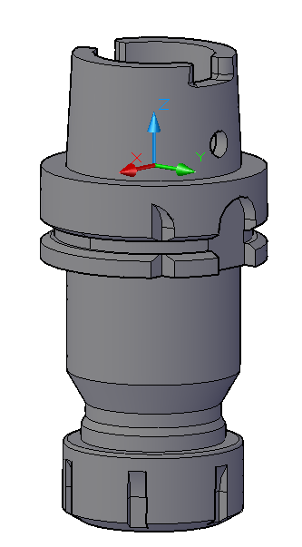

Level of detail for 3D solids
  • Only simple models rotated: only cylinder, no chip space, no indexable inserts, no internal coolant, no “inner life”. Close the clamping chuck at the front. Otherwise, the drill is dangling in the air.
  • Avoid radiuses, arcs and too many cylinders, which are not collision relevant. This makes simulation slow.
  • Watch for items that are plugged into each other to ensure that the distance between them is not too great.
  • Avoid gaps in the assembling area to get a volume model and not a surface model.
  • For cutting tools: At least two bodies are necessary to differentiate between CUT/NOCUT.
  • For standing tools: Planar cutting surfaces are necessary for indexable inserts.
  • The resulting slice curves must consist of lines and arcs.

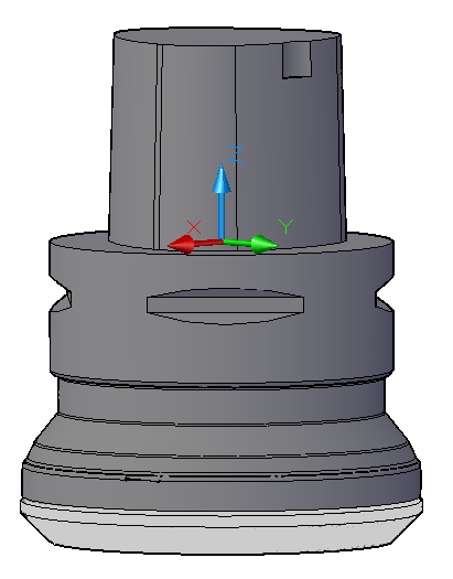

The Coromant Capto® shank (left image) is very detailed and might lead to a different shape if the contour is needed for the CAM Interface.
The cutter body consists of many arcs and few little lines. Therefore, for usage in simulation, a simplified geometry shown on the right is much better.
