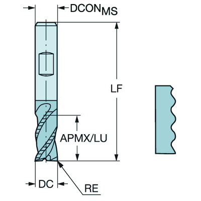

Cutting diameter (DC)info
14 mmSearch Icon
Tool cutting edge angle (KAPR)info
90 °Search Icon
Cutting diameter face contact(DCF)info
13.2 mmSearch Icon
Corner radius (RE)info
0.4 mmSearch Icon
26 mmSearch Icon
Rotational speed maximum(RPMX)info
80,000 1/minSearch Icon
Depth of cut maximum(APMX_PFW)info
26 mmSearch Icon
Center cutting capability(CCC)info
YesSearch Icon
Depth of cut maximum(APMX_FFW)info
26 mmSearch Icon
Usable length (LU)info
26 mmSearch Icon
Peripheral effective cutting edge count(ZEFP)info
4Search Icon
Weldon (DIN6535-HB) -metric: 14Search Icon
Maximum ramping angle(RMPX_FFW)info
5 °Search Icon
Grade (GRADE)info
1640Search Icon
Substrate(SUBSTRATE)info
HCSearch Icon
Coating(COATING)info
PVD TiAlNSearch Icon
Shank standard group(BSG)info
DIN 6527 LSearch Icon
Functional length(LF)info
83 mmSearch Icon
Tolerance class cutting diameter(TCDC)info
h12Search Icon
Interupted edge property(IEP)info
YesSearch Icon
Chip breaker(CBMD)info
HRSearch Icon
Radial rake angle(GAMF)info
10.5 °Search Icon
Axial rake angle(GAMP)info
13.5 °Search Icon
Flute helix angle(FHA)info
40 °Search Icon
Weight of item(WT)info
0.179 kgSearch Icon
Overall length(OAL)info
83 mmSearch Icon
