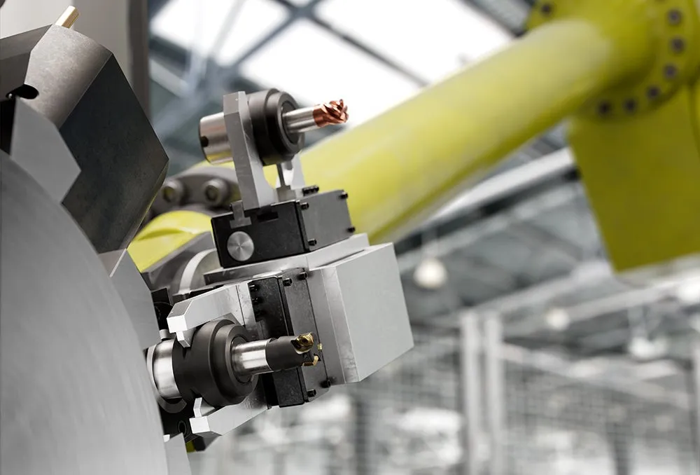

After using ATC technology for several years, Sandvik Coromant has now developed a solution for its customers that enables hands-free tool changes in turning operations. The new ATC system for machine-adapted clamping units (MACU) in turning centers fully automates the tool-changing process, eliminating the need for manual intervention. This leads to higher machine utilisation and improved productivity.

Sandvik Coromant’s ATC is applicable in turning centers and multi-task machines, requiring a MACU with a Coromant Capto® interface. For turning centers, an ATC-enabled MACU turret is necessary, while multi-task machines with a lower turret can utilise ATC if the turret is ATC-prepared. Learn more by visiting the website.
