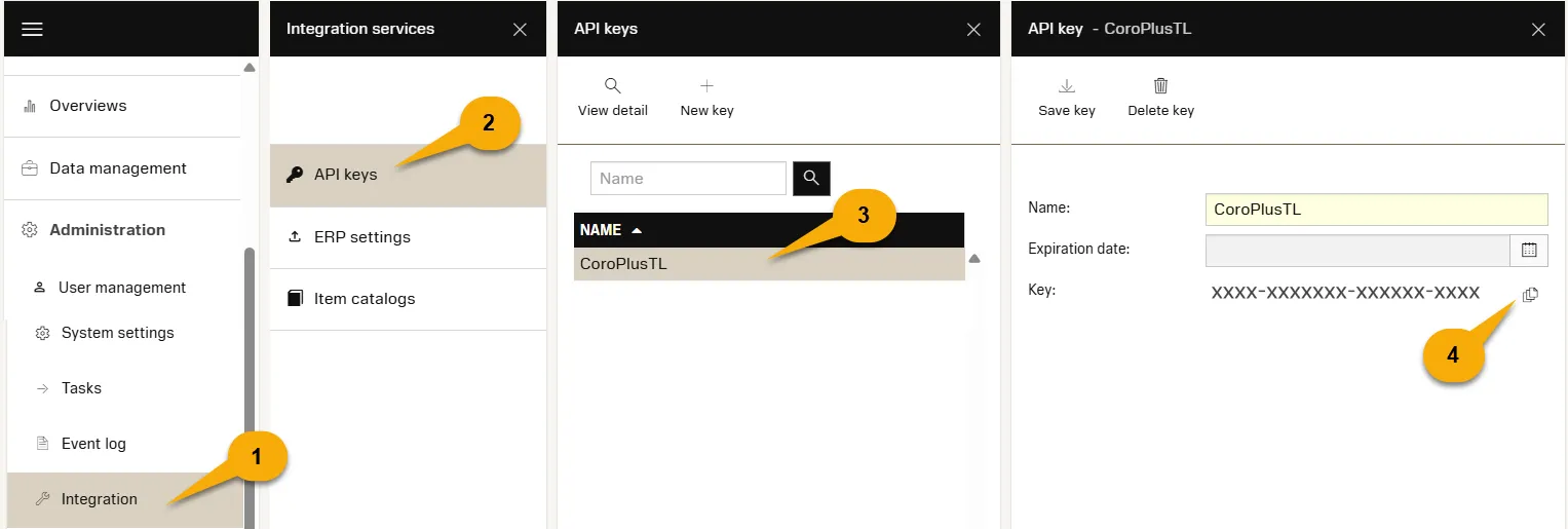

  1. Go to Integration in the Administration section of the CoroPlus® Tool Supply admin portal.
  2. Select API keys in Integration services.
  3. Select existing keys or create a New key if required.
  4. Copy the key value. You will use this in CoroPlus® Tool Library as described in the next section.

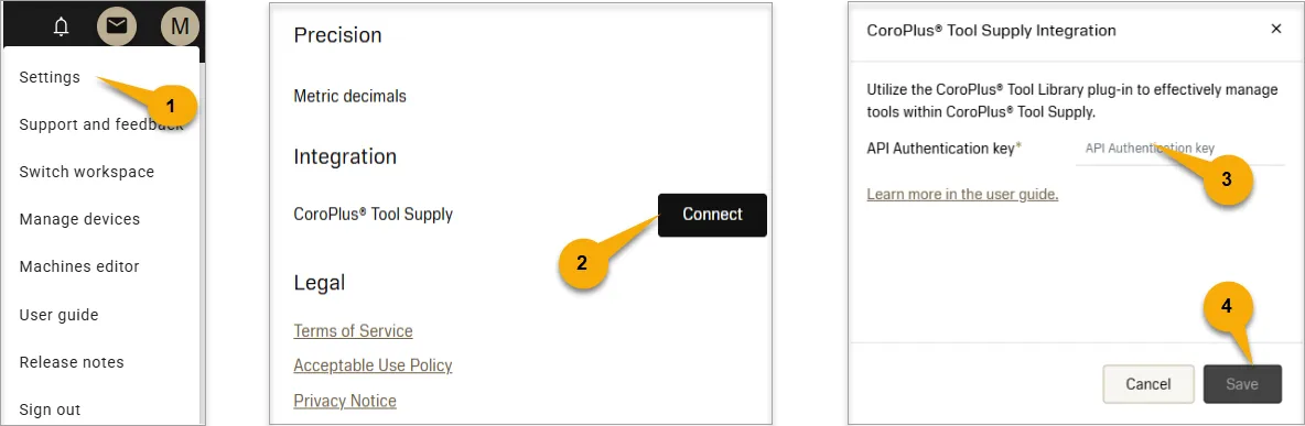

  1. Go to Settings in CoroPlus® Tool Library.
  2. In Integration, you will find CoroPlus® Tool Supply. Click Connect.
  3. Enter your API Authentication key obtained from CoroPlus® Tool Supply.
  4. Press Save to establish the connection to CoroPlus® Tool Supply.

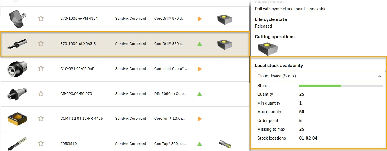

Viewing stock availability data
For each item/assembly that has stock availability data, a stock availability status is derived using this formula:
  • Available (green triangle, up): In stock quantity is larger than the order point.
  • Few in stock (orange triangle, right): In stock quantity is smaller than the order point, but larger than the minimum quantity.
  • Unavailable (red triangle, down): In stock quantity is smaller than the minimum quantity.

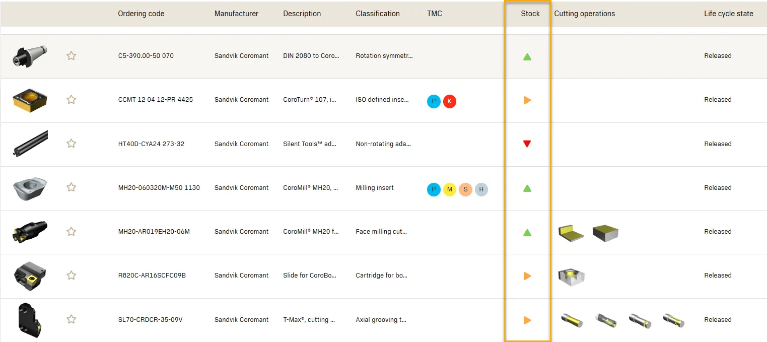

Grid view
Once you’ve added your API key, a new column called Stock will appear in the list views for assemblies and catalogue items. When the stock data has been synchronised, availability information will be shown in this column. If no stock data is available for an item, the column will remain empty.

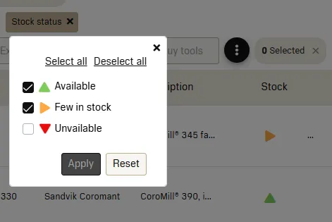

You can filter on stock availability by clicking Stock status amongst the filters in the search input.

If an item has stock availability data, it will be displayed in the panel on the right side when viewing its details.

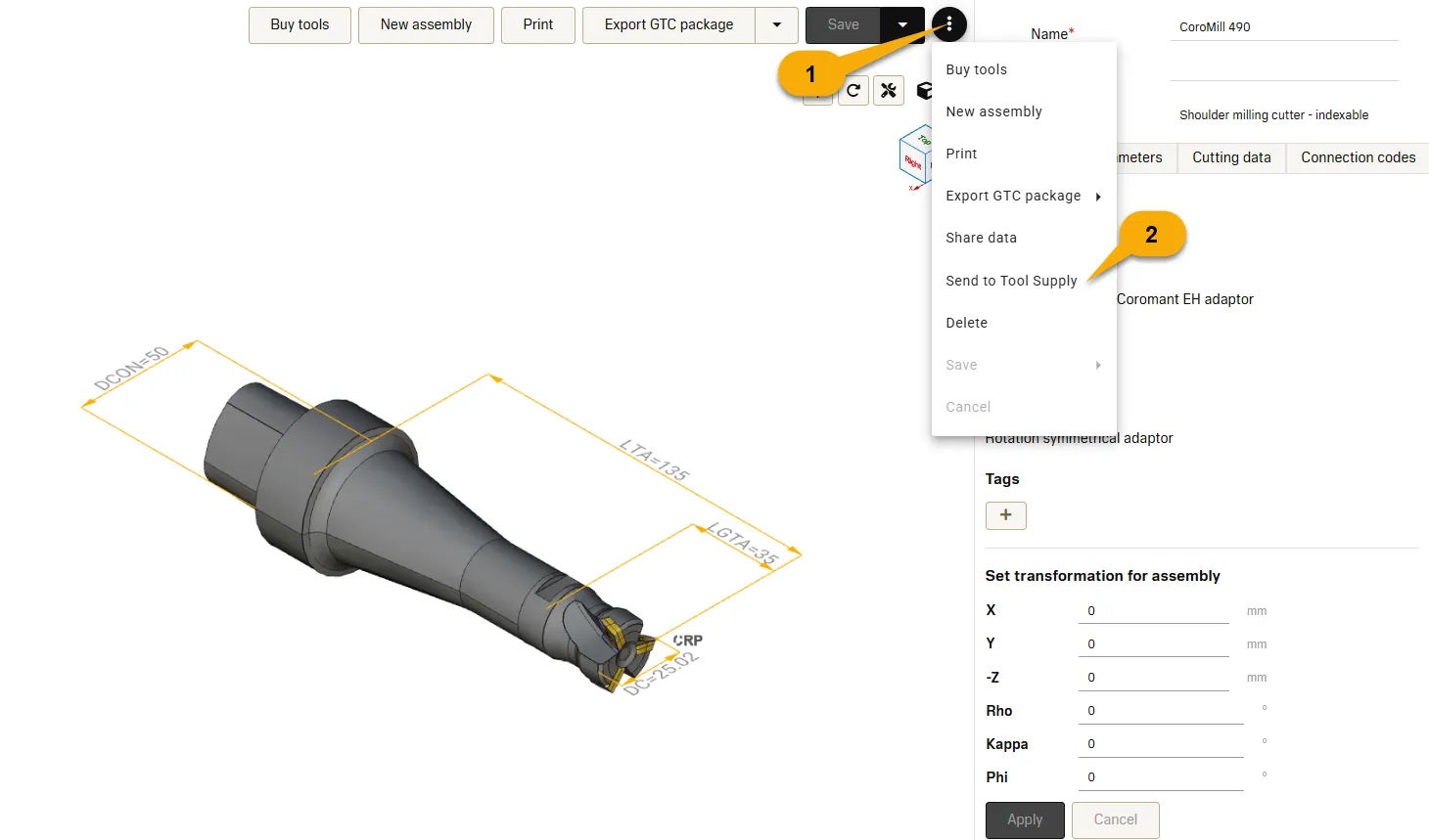

There are two ways to transfer assembly data to CoroPlus® Tool Supply: in the My Assemblies view or the Assembly Building view.
Assembly building view
  1. Select the three-dot button.
  2. Click Send to Tool Supply.

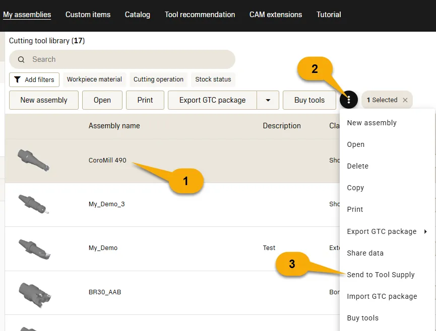

My assemblies view
  1. Select any assembly from the list.
  2. Select the three-dot button.
  3. Click Send to Tool Supply.
