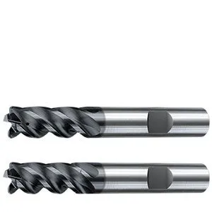

A game-changer
An undisputable game-changer, CoroMill® Plura HD brings the highest performing tool life to the market in ISO P and ISO M. CoroMill® Plura HD is the first choice for heavy-duty applications in ISO P and ISO M materials of up to 2×D roughing in steel and stainless steel.
Exceptional metal removal rates
With its optimized flute shape for effective chip evacuation and internal coolant for stainless steel, the CoroMill® Plura HD ensures world-class productivity with exceptional metal removal rates and high process security.

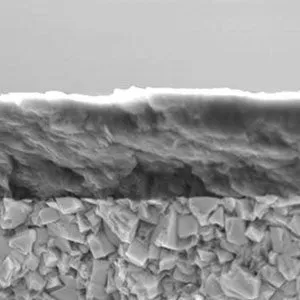

Zertivo™ 2.0
Zertivo™ 2.0 coating technology offers superior tool life and high productivity, while providing unparalleled process security in wide-ranging applications.
When to use
  • First choice for roughing in steel or stainless steel with the highest productivity
  • 2xD full slot capabilities and excellent ramping capabilities
Benefits and features
Stable milling with low vibration
  • Differential pitch
  • Cutting edge preparation and relief design
High metal removal rate
  • Optimized flute design
  • Tough grades
  • Stainless steel (M) geometry with radial exit internal coolant for improved chip and temperature control
  • Steel P-geometries available with 4 and 5 teeth, based on the hardness of your material: 4 teeth for HRc ≤ 48 HRc, 5 teeth for HRc ≤ 30 HRc
Superior tool life
  • Grades PB2M and M2CM feature our Zertivo™ 2.0 coating technology for superior tool life in steel (ISO P) and stainless steel (ISO M)
