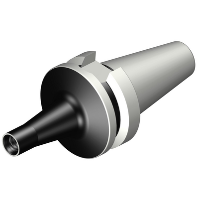

392.55EH-30 12 063content_copy
392.55EH-30 12 063
Specifieke vertegenwoordiging
Lijstprijs: 371.00 EURfile_copy
Verpakkingshoeveelheid: 1
ISO: 392.55EH-30 12 063file_copy
Materiaal-ID: 6048659file_copy
EAN: 26048659file_copy
ANSI: 392.55EH-30 12 063file_copy

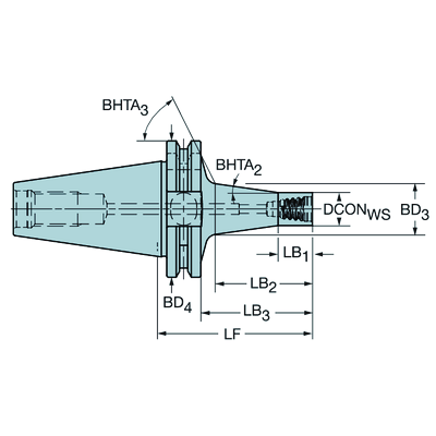

Technische illustraties
Productgegevens
MAS-BT403 -AD central coolant - BT30Search Icon
Coromant EH -metric - E12Search Icon
Koelmiddeldruk(CP)info
1.160 PSISearch Icon
Functionele diameter(DFC)info
1,25 inchSearch Icon
Draadmaat aantrekbout(CRKS)info
Metric M12Search Icon
0,4567 inchSearch Icon
Kappa (z-as rot)(KAP)info
Functionele lengte(LF)info
2,4803 inchSearch Icon
Body-diameter(BD_1)info
Body-diameter(BD_2)info
Body-diameter(BD_3)info
0,7008 inchSearch Icon
Body-diameter(BD_4)info
1,811 inchSearch Icon
Body-lengte(LB_1)info
0,4724 inchSearch Icon
Body-lengte(LB_2)info
1,3425 inchSearch Icon
Body-lengte(LB_3)info
1,6142 inchSearch Icon
Body-lengte(LB_4)info
8 °Search Icon
Body half conushoek(BHTA_3)info
64 °Search Icon
Body half conushoek(BHTA_4)info
Koppel(TQ)info
11,0634 ftlbfSearch Icon
Maximale toerental(RPMX)info
25.000 1/minSearch Icon
Body materiaal (BMC)info
StaalSearch Icon
Gewicht van item(WT)info
0,9921 lbSearch Icon
Totale lengte(OAL)info
4,3858 inchSearch Icon
20-09-2011Search Icon
11.2Search Icon
