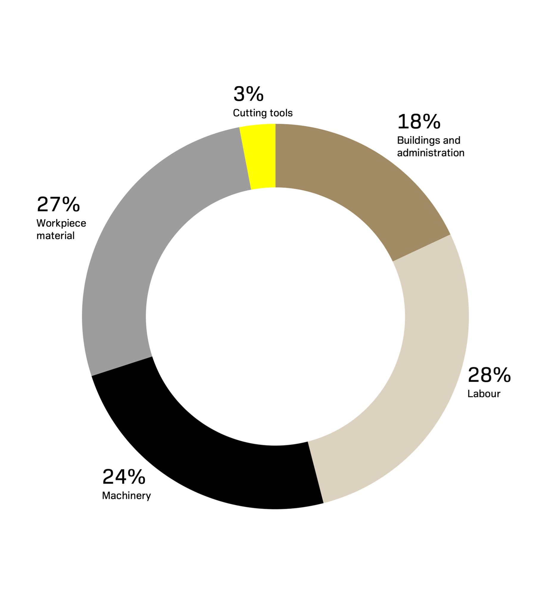

In a typical workshop, this is the split between different expenses that make up the total manufacturing costs (chart on the left). Good design and planning in the early stages of a project can prevent unexpected expenditures later on. Conversely, poor machining practices and suboptimal component design can result in a significant increase in process and material costs.
