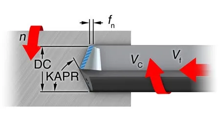

Parametry skrawania
Parametry skrawania
CFRP - 60 smm (200 sfm) .08 mm/obr. (.003 cale/obr.)
Aluminium - 60 smm (200 sfm) .08 mm/obr. (.003 cale/obr.)
Tytan - 15 smm (50 sfm) .05 mm/obr. (.002 cale/obr.)
Stal nierdzewna - 15 smm (50 sfm) .05 mm/obr. (.002 cale/obr.)
