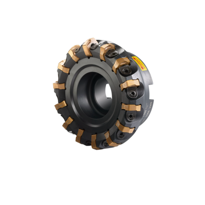

L365-125Q40-W15Hfile_copy
L365-125Q40-W15H
ISO: L365-125Q40-W15Hfile_copy
Material Id: 5735329file_copy
EAN: 12304434file_copy
ANSI: L365-125Q40-W15Hfile_copy
Tool cutting edge angle (KAPR)info
65 °Search Icon
Cutting diameter (DC)info
125 mmSearch Icon
Maximum cutting diameter(DCX)info
131.7 mmSearch Icon
Cutting item count(CICT_2)info
18Search Icon
Clamping type code(MTP)info
Wedge clampingSearch Icon
Part 2 of cutting item interface identifiers(CUTINT_MASTER_2)info
CoroMill 365 -size 15 (L365-1505ZNE)Search Icon
Depth of cut maximum(APMX_FFW)info
6 mmSearch Icon
Maximum ramping angle (RMPX)info
Maximum plunge depth(AZ)info
Peripheral effective cutting edge count(ZEFP)info
18Search Icon
Arbor -ISO 6462 -B (cutter retaining screw) -metric: 40Search Icon
Hand (HAND)info
Coolant entry style(CNSC)info
Connection diameter machine side(DCONMS)info
40 mmSearch Icon
Standard number(STDNO)info
ISO6462Search Icon
Standard letter(STDLET)info
BSearch Icon
Functional length(LF)info
63 mmSearch Icon
Radial rake angle(GAMF)info
-5.6977 °Search Icon
Axial rake angle(GAMP)info
-10.3151 °Search Icon
Torque(TQ)info
6 NmSearch Icon
Body material(BMC)info
SteelSearch Icon
Rotational speed maximum(RPMX)info
8,800 1/minSearch Icon
Weight of item(WT)info
4 kgSearch Icon
Overall length(OAL)info
63 mmSearch Icon
