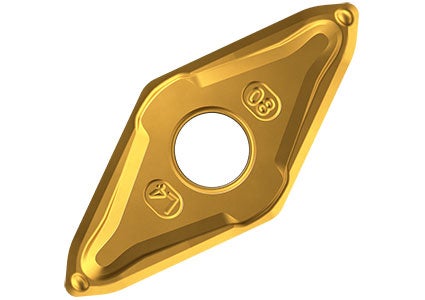

Performance
L4 geometry
Component:Slicing blade
Material:100 Cr 6, P1.1.Z.AN (CMC 02.2), 250 HB
Operation:Roughing, continuous cut
Machine:Okuma
132%
Reduced cycle time
+250%
Tool life
Competitor Sandvik Coromant
InsertCNMG 120412CP-B1108-L4 GC4325
vc m/min (ft/min) 350 (​1148)400 (1300)
fn mm/rev (in/rev) 0.35 (0.014)0.8 (0.03)
ap mm (inch) 2 (0.079)2 (0.079)
Tool life13 45
Time in cut per component58 sec25 sec
Result: The -L4 geometry achieves extremely good chip control and boost the productivity for this thin and slender component.
