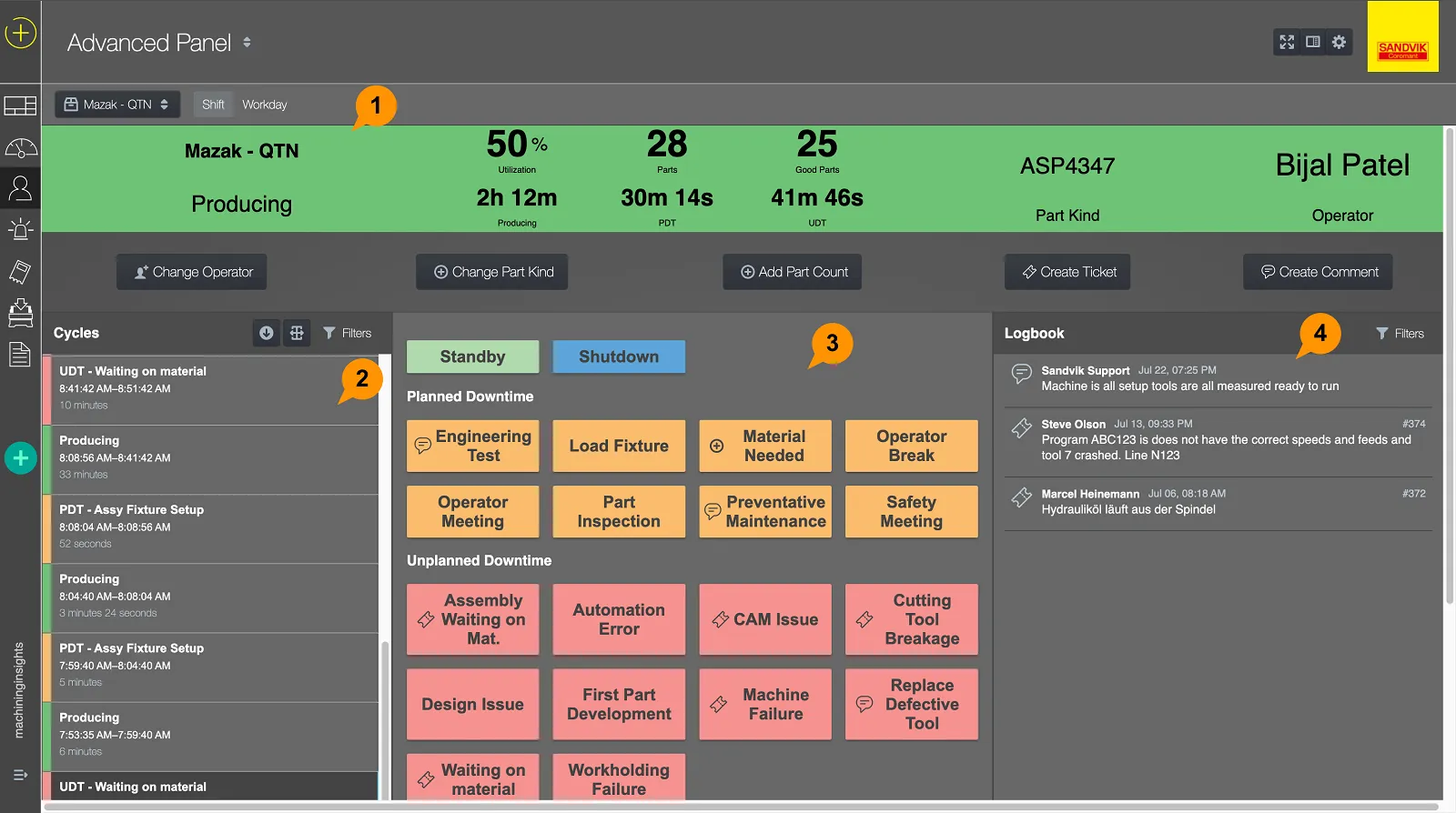

Layout
CoroPlus® Machining Insights offers two Operator Panels, a Standard Panel and an Advanced Panel. Both panels follow the same layout. However, the Advanced Panel allows changing the operator, the part kind and the part count.
The Operator Panel consists of four sections.
  1. Information
    In this section, you get all the vital information on a glace. On top, you see the machine name and if the data are by workday or shift. The colour (green, yellow or red) represents the current production status. In addition, you can see within the colour bar further information like the number of parts, the production time and which part is currently being processed. Below the coloured bar are different buttons, like Switch Operator or Create Comment, for quick adjustments.
  2. Cycles
    The Cycles list displays all past cycles.
  3. Classification buttons
    This section shows buttons for all possible downtime classifications, Standby and Shutdown. You can choose from these buttons for the classification of a cycle.
  4. Logbook
    The Logbook shows all created tickets and comments for this machine and workday/shift.

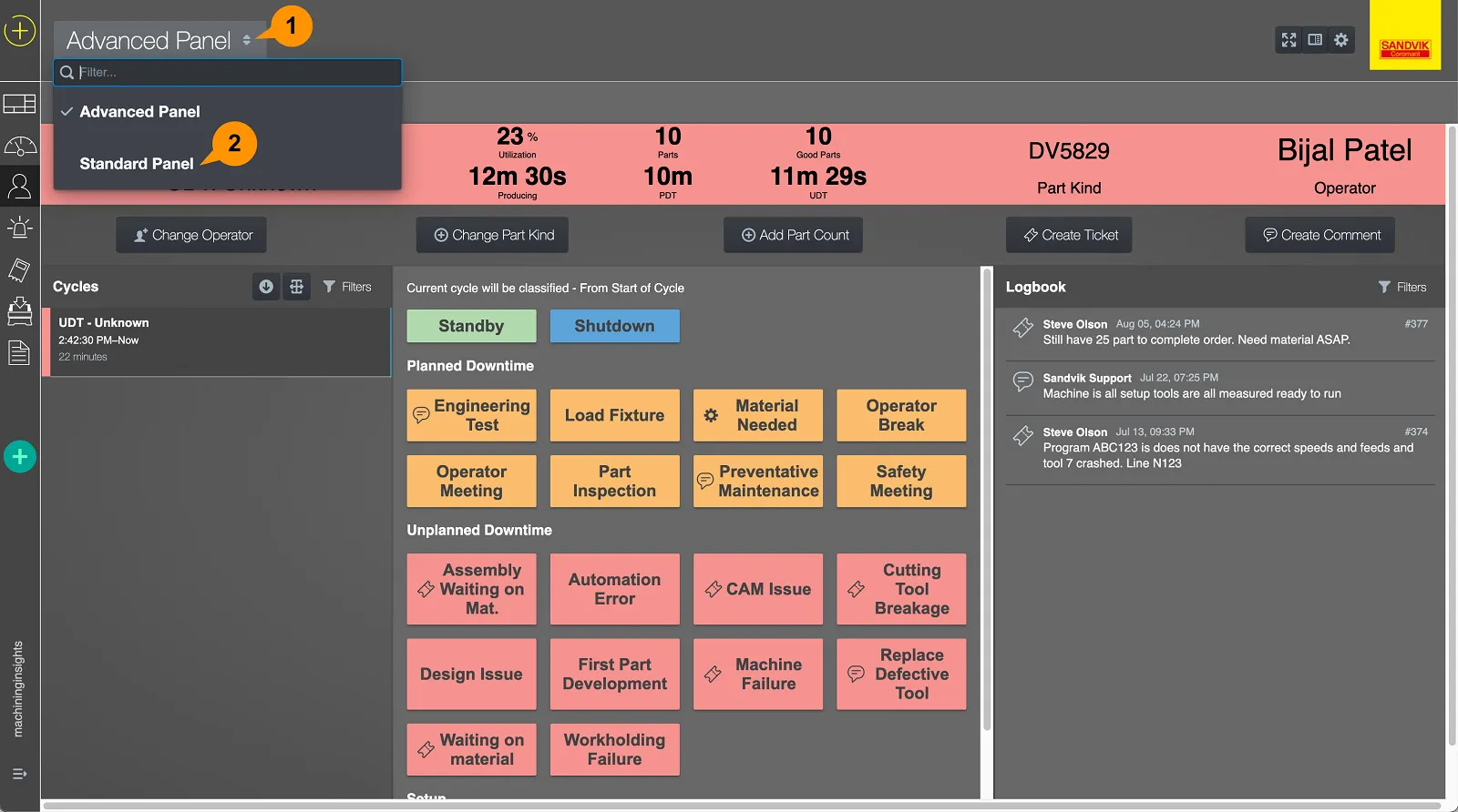

Switch panel
If you want to switch to another panel, do the following:
  1. Click the panels’ name. This will open a list of all configured panels.
  2. Click the panel you want to switch to.

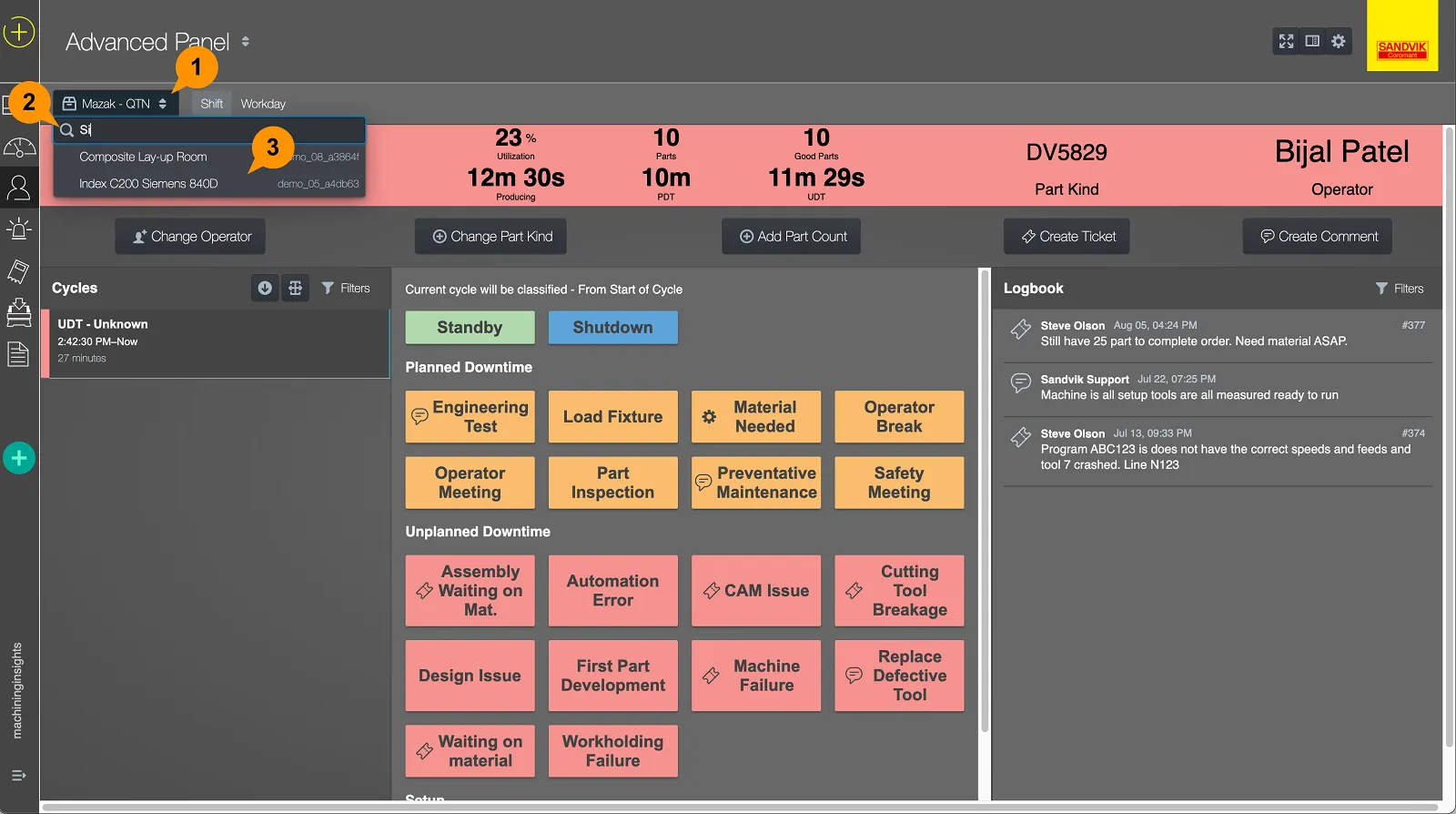

Switch device
When you open a panel, you must select the machine you want to view. If you already have a panel open and you want to view the status of another machine, do the following:
  1. Click the device name. This will open a list of all configured devices.
  2. Filter the list if necessary.
  3. Click the device you want to switch to.
