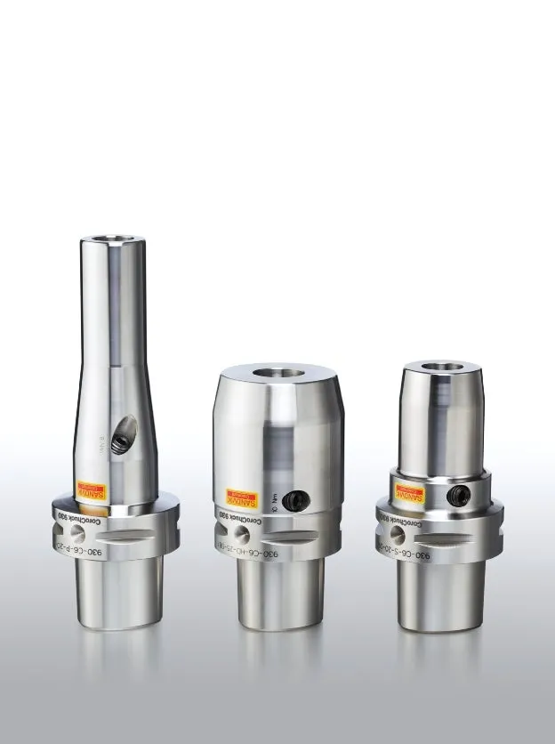

6. Hang on Tight
CoroChuck 930
Titanium tends to grab end mills under heavy loads, pulling them out of the toolholder. This leads to scrapped workpieces and broken tools. Some shops turn to Weldon shank holders as a way to secure tools, only to find cutter vibration loosens even the most tightly torqued setscrews. Shrink fit holders are a good choice, but require some small investment in an induction heating station for tool changing. For a no-fail grip, a Safe-Lock or equivalent system secures toolholders tightly and accurately. Hydraulic holders like the Sandvik Coromant utilize the latest technology and will prevent pull out. On the workholding side of the equation, a hydraulic vise with hardened and ground jaws is the best bet for clamping titanium parts—a serrated or knife-edge jaw gives an extra bite during roughing operations.
