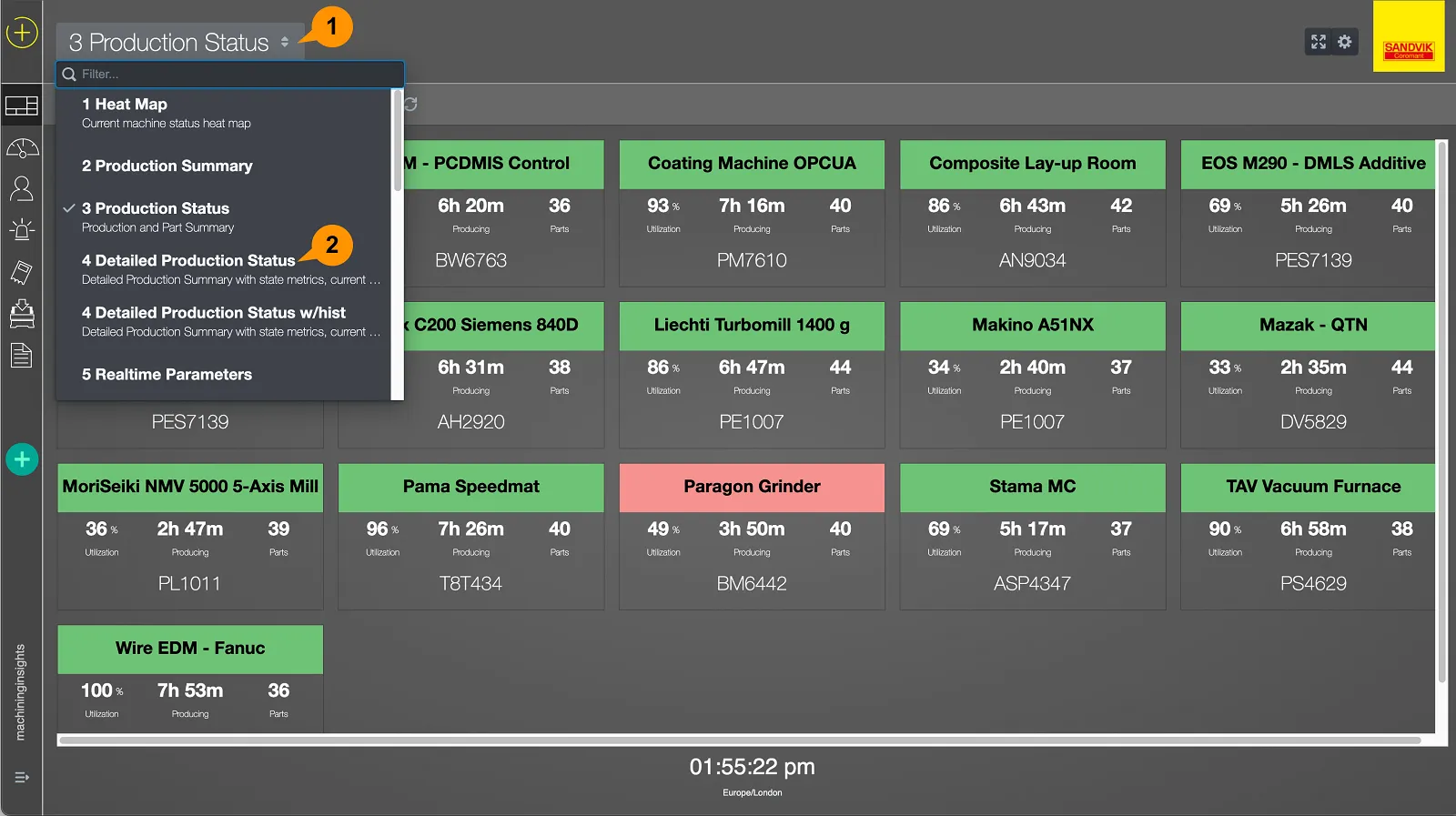

If you already have a dashboard open and want to switch to another dashboard, do the following:
  1. Click the dashboard name. This will open a list of all configured dashboards.
  2. Click the dashboard you want to switch to.
