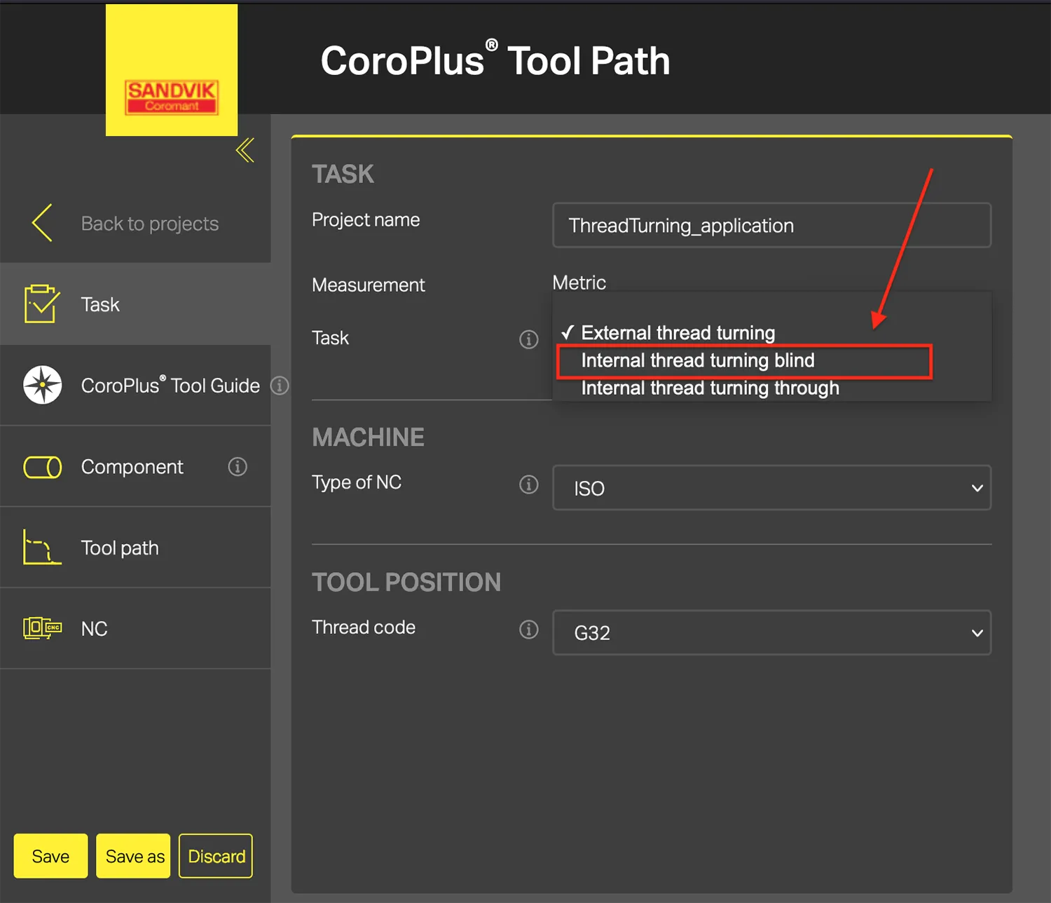

How to set up an operation with an in blind hole?
To set up a thread turning operation which creates a thread in a blind hole you need to define the corresponding task for that operation.
Select Internal threadturning blind in the Task combo box.
