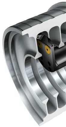

Engineered solutions can reduce the number of operations and the cutting time of power components. To machine deeper, internal chambers you need state-of-theart tooling solutions – such as those developed through Silent Tool concepts. Dampened tool blades are crucial to maintaining satisfactory performance without limitations from vibration tendencies and chip congestion. Blades longer than four times the width of the blade are designed with a patented dampened device and this allows the depth of cut to be four times greater than without dampening.
Having built-in dampening for ensuring performance at extended tool reach, these blades turn features in deep grooves often at some 20% higher cutting speeds with tool life being 50% longer.
