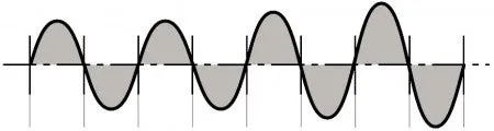

Differential-pitched cutters have unequal spacing of the teeth around the cutter. These cutters are advantageous because they break up harmonic vibrations, which in turn increases stability and reduces the risk of vibration. This is especially useful when milling with high width of cut, ae, and long overhangs.
Normal pitch
Differential pitch

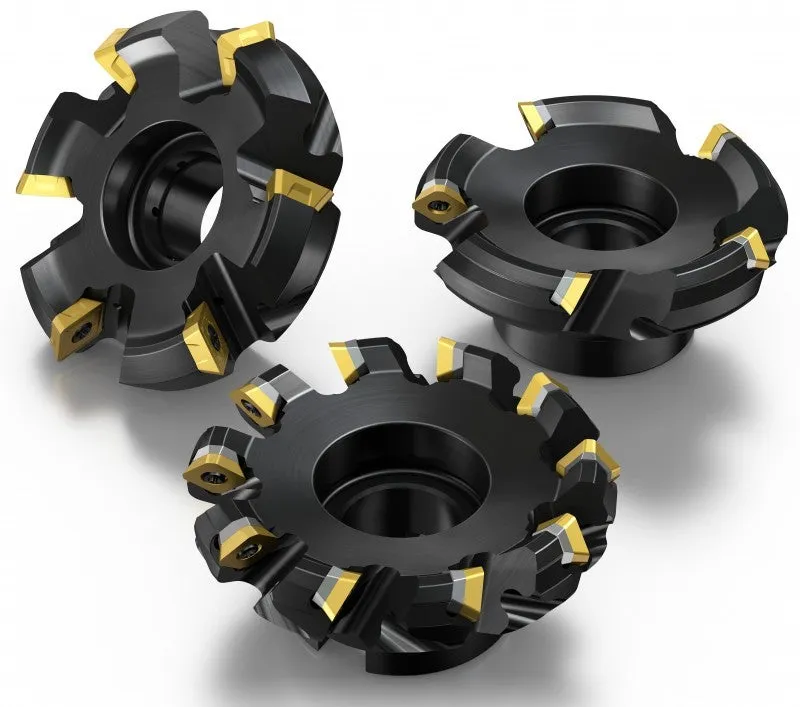

Coarse, close and extra close pitch
There are normally three different pitches to choose from that can help you to optimize the application: coarse, close and extra close pitches.
The closer pitch cutters are used when stability is good and for low ae applications. This ensures that more than one tooth always is engaged in cut.
Coarse pitch
Close pitch
Extra close pitch
Coarse pitch milling cutters, -L
Differential-pitched cutters with low number of edges.
  • First choice for unstable operations due to lowest cutting forces
  • Limited power
  • Extended tooling
  • Full slotting operations
  • Long-chipping materials ISO N (large chip pocket)
Close pitch milling cutters, -M
Even or differential-pitched cutters with medium number of edges.
  • First choice for roughing in stable conditions
  • Good productivity
  • Good chip space for roughing in ISO P, M and S materials
Extra close pitch milling cutters, -H
Even-pitched cutters with maximum number of inserts.
  • First choice for high productivity with low ae – more than one tooth is always engaged in cut
  • Roughing and finishing in ISO K materials
  • Roughing in ISO S materials in combination with round inserts
Note: An X added to the code, describes a cutter version that has a slightly closer pitch than its basic design
