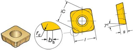

| iC | Dimensions, mm (inch) | Uncut material | ||
| R | b | ap | x | |
| 9 | 2.5 (.098) | 7.05 (.278) | 1.2 (.047) | 0.79 (.031) |
| 14 | 3.5 (.138) | 12.0 (.472) | 2.0 (.079) | 1.48 (.058) |

| Dimensions | ap, mm (inch) | ea, mm (inch) |
| 9 | 1.2 (0.047) | 8 (0.315) |
| 14 | 2.0 (0.079) | 13 (0.512) |
