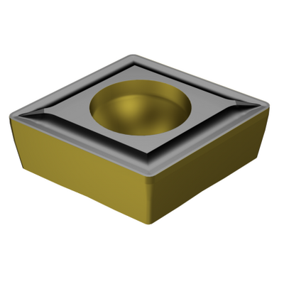

CCMT 09 T3 04-UF 4425file_copy
Package quantity: 10
ISO: CCMT 09 T3 04-UF 4425file_copy
Material Id: 7860903file_copy
EAN: 7323225048712file_copy
ANSI: CCMT 3(2.5)1-UF 4425file_copy

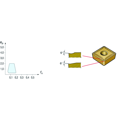

Start values  (KAPR 95 deg)
ap0.4  mm  (0.2 - 2)
fn0.1  mm/r  (0.05 - 0.2)
hex0.1  mm/r  (0.05 - 0.2)
vc430  m/min  (465 - 375)
k
ap0.4  mm  (0.2 - 2)
vc265  m/min  (285 - 220)

Chip breaker(CBMD)info
UFSearch Icon
Operation type (CTPT)info
finishingSearch Icon
Insert mounting style code(IFS)info
Fixing hole diameter(D1)info
4.4 mmSearch Icon
CC09T3Search Icon
Cutting edge count(CEDC)info
2Search Icon
9.525 mmSearch Icon
Insert shape code(SC)info
Rhombic 80Search Icon
9.2719 mmSearch Icon
Corner radius (RE)info
0.3969 mmSearch Icon
Hand (HAND)info
NeutralSearch Icon
Grade (GRADE)info
4425Search Icon
Substrate(SUBSTRATE)info
HCSearch Icon
Coating(COATING)info
CVD TiCN+Al2O3+TiNSearch Icon
Insert thickness(S)info
3.9688 mmSearch Icon
Clearance angle major(AN)info
7 °Search Icon
Weight of item(WT)info
0.003 kgSearch Icon
Insert seat(SSC_M)info
09Search Icon
