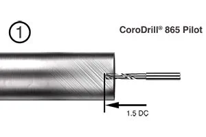

Piloting Strategy
The range of drills for deep holes has a complementary range of high performance pilot drills.
The pilot drills are designed to work with the deep hole drills to give maximum accuracy in drill location and minimum hole run out.  Due to the body tolerance being p7, applying a pilot drill strategy will also extend tool life of the deep hole drill.

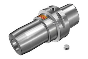

Tool holding
Sandvik Coromant always strongly recommends CoroChuck 930 for maximum precision and reliability.
