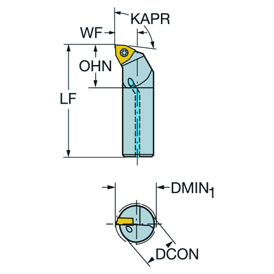

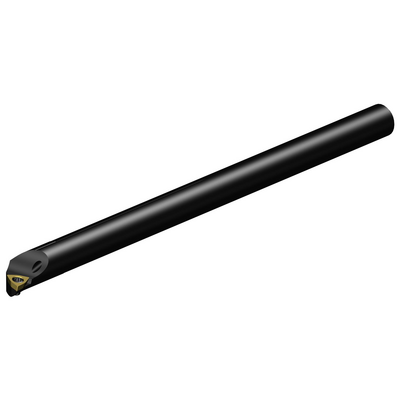

Specific representation
ISO: E08K-SWLPR 02-Rfile_copy
Material Id: 5733587file_copy
EAN: 11315172file_copy
ANSI: E08K-SWLPR 02-Rfile_copy
Tool cutting edge angle(KAPR_1)info
95 °Search Icon
Lead angle(PSIR)info
-5 °Search Icon
Clamping type code(MTP)info
Insert type(CUTINT_MASTER)info
WPMT 020102Search Icon
Cylindrical shank without clamping features (without flange) -metric: 8.00Search Icon
Maximum ramping angle (RMPX)info
Minimum bore diameter (DMIN_1)info
10 mmSearch Icon
Workpiece side body angle (BAWS)info
Minimum overhang(OHN)info
17 mmSearch Icon
Maximum overhang (OHX)info
48 mmSearch Icon
Hand (HAND)info
Coolant exit style(CXSC)info
Coolant entry style(CNSC)info
Coolant pressure(CP)info
10 barSearch Icon
Location aid property(LOCAP)info
YesSearch Icon
Connection diameter machine side(DCONMS)info
8 mmSearch Icon
Functional length(LF)info
125 mmSearch Icon
Functional width(WF)info
5 mmSearch Icon
Functional height(HF)info
Body diameter(BD)info
8 mmSearch Icon
Orthogonal rake angle(GAMO)info
2 °Search Icon
Inclination angle(LAMS)info
-10 °Search Icon
Torque(TQ)info
0.6 NmSearch Icon
Body material(BMC)info
CarbideSearch Icon
Weight of item(WT)info
0.041 kgSearch Icon
Master insert identification(MIID)info
WPMT 02 01 02Search Icon
Overall length(OAL)info
125 mmSearch Icon
Insert seat - metric(SSC_M)info
02Search Icon
5/32Search Icon
1/28/02Search Icon
