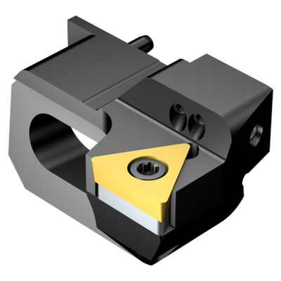

CoroBore® BR20 cartridge for boring
ISO: BR20-GA-TC16F-22
Material Id: 7591830
EAN: 7323223833198
ANSI: BR20-GA-TC16F-22

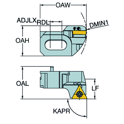

Tool cutting edge angle
(KAPR)
Clamping type code
Insert type
TCMT 16T308
BR20 slide -size G (side A)
Minimum bore diameter
(DMIN)
89 mm
Adjustability
(ADJBY)
Yes
radial entry
Coolant pressure
70 bar
22 mm
Functional width
32.5 mm
35.2 mm
Overall height
(OAH)
32.8 mm
Overall width
(OAW)
61 mm
3 Nm
0.18 kg
22/09/2018
18.2
