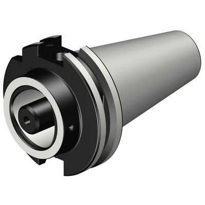

ISO 7388-1 to Coromant Capto® adaptor
Specific representation
ISO: C4-390B.140-40 030
Material Id: 6408249
EAN: 26408249
ANSI: C4-390B.140-40 030
ISO7388.1/DIN69871 -AD/B central/flange: ISO40
Connection - workpiece side
(ADINTWS)
Coromant Capto (bolt clamping) -size C4
Coolant exit style
axial concentric exit
Coolant pressure
80 bar
Functional diameter
(DFC)
44.45 mm
Standard number
(STDNO)
ISO7388-1
Standard letter
(STDLET)
AD/AF
Connection retention knob thread size
(CRKS)
Metric M16
Connection diameter workpiece side
(DCONWS)
40 mm
Kappa (z-axis rot)
(KAP)
30 mm
Body diameter
(BD_1)
40 mm
Body diameter
(BD_2)
63.5 mm
Body length
(LB_1)
10.9 mm
Body length
(LB_2)
30 mm
Body half taper angle
(BHTA_1)
(BHTA_2)
55 Nm
Body material
Steel
Balancing method code
(BLMC)
Balancing by design
0.7983 kg
98.4 mm
