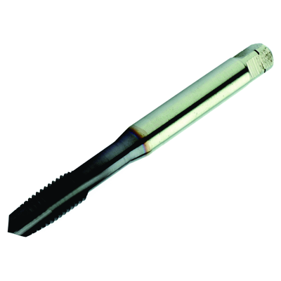

CoroTap® 200, cutting tap with spiral point
Being replaced by
T200-MM101AE-1/2 C110
Available within a week
Fully exchangeable with the original product.
Out of stock
ISO: E8721/2
Material Id: 6182259
EAN: 26182259
ANSI: E8721/2
Thread size
(TDZ)
UNC 1/2-13
Thread form
(THFT)
UNC 60°
Tap chamfer length
(TCL)
8.325 mm
Threads per inch
(TPI)
13
Thread diameter
(TD)
12.7 mm
Premachined hole diameter
(PHD)
10.8 mm
Premachined hole type
(PHT)
through hole
Hole type
(HTY)
through hole
Thread tolerance class
(TCTR)
2B
Shank standard group
(BSG)
DIN/ANSI
Usable length
81.8 mm
Tap shank ANSI -inch: 0.367 x 0.275
Chip breaker
MM
T3J9
HSS-PM
PVD TiAlN+WC/C
Coolant exit style
9.3218 mm
Connection diameter tolerance
(TCDCON)
h9
110 mm
Neck diameter
(DN)
8.9 mm
Flute count
(NOF)
Flute helix angle
(FHA)
Radial rake angle
(GAMF)
7 °
Threading length
(THL)
23 mm
Threading chamfer type
(THCHT)
B = 3.5-5xTP Gunnose
0.064 kg
110 mm
12/12/2011
