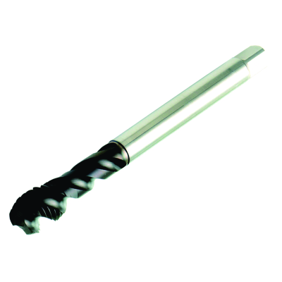

Being replaced by T300-PM105AE-7/8 P1PM
Different geometry and grade vs. the original one – Please check feed.
ISO: EX29PA7/8file_copy
Material Id: 6162612file_copy
EAN: 26162612file_copy
ANSI: EX29PA7/8file_copy

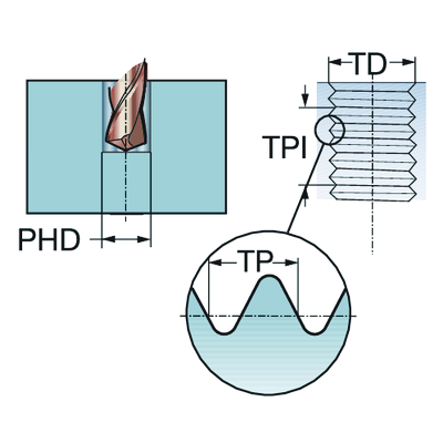

Thread size(TDZ)info
UNC 7/8-9Search Icon
Thread form(THFT)info
UNC 60°Search Icon
Tap chamfer length(TCL)info
5.541 mmSearch Icon
Threads per inch(TPI)info
9Search Icon
Thread diameter(TD)info
22.225 mmSearch Icon
Premachined hole diameter(PHD)info
19.5 mmSearch Icon
blind holeSearch Icon
Hole type(HTY)info
Thread tolerance class(TCTR)info
2BXSearch Icon
Shank standard group(BSG)info

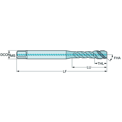

Usable length (LU)info
90.9 mmSearch Icon
Tap shank ANSI -inch: 0.697 x 0.523Search Icon
Chip breaker(CBMD)info
PMSearch Icon
Grade (GRADE)info
T4I1Search Icon
Substrate(SUBSTRATE)info
HSS-E-PMSearch Icon
Coating(COATING)info
PVD TiAlNSearch Icon
Coolant entry style(CNSC)info
Coolant exit style(CXSC)info
Coolant pressure(CP)info
10 barSearch Icon
Connection diameter machine side(DCONMS)info
17.7038 mmSearch Icon
Connection diameter tolerance(TCDCON)info
h9Search Icon
Functional length(LF)info
140 mmSearch Icon
Neck diameter(DN)info
17.3 mmSearch Icon
Flute count(NOF)info
4Search Icon
Flute helix angle(FHA)info
48 °Search Icon
Radial rake angle(GAMF)info
13 °Search Icon
Threading length(THL)info
25.0012 mmSearch Icon
Thread back taper property(THBTP)info
YesSearch Icon
Threading chamfer type(THCHT)info
C = 2-3xTPSearch Icon
Weight of item(WT)info
0.227 kgSearch Icon
Overall length(OAL)info
140 mmSearch Icon
