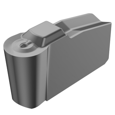

N151.2-800-60-4P H13Afile_copy
Package quantity: 10
ISO: N151.2-800-60-4P H13Afile_copy
Material Id: 5737815file_copy
EAN: 10234545file_copy
ANSI: N151.2-800-60-4P H13Afile_copy

MKNSSearch Icon
Chip breaker(CBMD)info
4PSearch Icon
Operation type (CTPT)info
finishingSearch Icon
Insert mounting style code(IFS)info
Concave prismatic sectionSearch Icon
Q-Cut 151.2 -size 60Search Icon
Cutting edge count(CEDC)info
1Search Icon
Insert seat(SSC_M)info
60Search Icon
Cutting width (CW)info
8 mmSearch Icon
Cutting width lower tolerance(CWTOLL)info
-0.02 mmSearch Icon
Cutting width upper tolerance(CWTOLU)info
0.02 mmSearch Icon
Corner radius (RE)info
4 mmSearch Icon
Corner radius lower tolerance(RETOLL)info
-0.02 mmSearch Icon
Corner radius upper tolerance(RETOLU)info
0.02 mmSearch Icon
3.6 mmSearch Icon
Hand (HAND)info
NeutralSearch Icon
Grade (GRADE)info
H13ASearch Icon
Insert thickness(S)info
10.318 mmSearch Icon
Clearance angle major(AN)info
7 °Search Icon
Weight of item(WT)info
0.0086 kgSearch Icon
