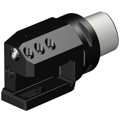

Coromant Capto® to rectangular shank adaptor
Specific representation
ISO: C6-ASHR-105-20HP
Material Id: 7086837
EAN: 7323221216542
ANSI: C6-ASHR-105-20HP

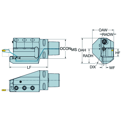

Connection - workpiece side
(ADINTWS)
Maximum overhang
105 mm
Coolant exit style
Coolant pressure
150 bar
Data chip pocket
(DCP)
Yes
Data chip pocket size
(DCPS)
Dia.=10 mm/Height=4,5 mm
63 mm
(LF_1)
105 mm
Functional width
(WF_1)
10 mm
Functional height
(HF_1)
20 mm
143 mm
Overall height
(OAH)
69 mm
Overall width
(OAW)
63.5 mm
Radial body height
(RADH)
37 mm
Radial body width
(RADW)
30 mm
Maximum tool changer interference diameter
(DIX)
85 mm
Body material
Steel
2.318 kg
19/02/2017
