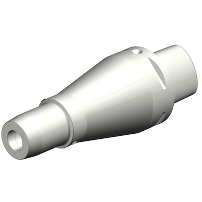

Coromant Capto® to CoroChuck® 930
Specific representation
ISO: 930-C8-S-20-175
Material Id: 6255470
EAN: 26255470
ANSI: 930-C8-S-20-175
Connection - workpiece side
(ADINTWS)
Hydraulic Membrane chuck -metric: 20
Coolant exit style
axial concentric exit
Coolant pressure
80 bar
80 mm
Functional diameter
(DFC)
55 mm
Standard number
(STDNO)
ISO26623-1
Connection diameter workpiece side
(DCONWS)
20 mm
Kappa (z-axis rot)
(KAP)
175 mm
Body diameter
(BD_1)
38 mm
Body diameter
(BD_2)
42 mm
Body diameter
(BD_3)
50 mm
Body diameter
(BD_4)
80 mm
Body length
(LB_1)
16 mm
Body length
(LB_2)
49.2 mm
Body length
(LB_3)
70 mm
Body length
(LB_4)
175 mm
Body half taper angle
(BHTA_1)
7 °
(BHTA_2)
(BHTA_3)
(BHTA_4)
8 Nm
Rotational speed maximum
14,000 1/min
Body material
Steel
Balancing method code
(BLMC)
Balancing by design
4.263 kg
223 mm
20/02/2013
13.1
