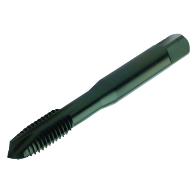

CoroTap® 200, cutting tap with spiral point
Being replaced by
T200-XM101AJ-1 C145
Available within a week
Fully exchangeable with the original product.
Out of stock
ISO: E0361-14
Material Id: 6181782
EAN: 26181782
ANSI: E0361-14
Thread size
(TDZ)
UNS 1"-14
Thread form
(THFT)
UN 60°
Tap chamfer length
(TCL)
7.8625 mm
Threads per inch
(TPI)
14
Thread diameter
(TD)
25.4 mm
Premachined hole diameter
(PHD)
23.5 mm
Premachined hole type
(PHT)
through hole
Hole type
(HTY)
through hole
Tolerance class tool
(TCT)
H4 = Basic Plus 0.0015" to Plus 0.0020"
Thread tolerance class
(TCTR)
3B
Shank standard group
(BSG)
ANSI
Usable length
65.575 mm
Tap shank ANSI -inch: 0.800 x 0.600
Chip breaker
XM
T3P4
HSS-PM
PVD FeN
Coolant exit style
20.32 mm
Connection diameter tolerance
(TCDCON)
h9
130.175 mm
Neck diameter
(DN)
19.9 mm
Flute count
(NOF)
3
Flute helix angle
(FHA)
Radial rake angle
(GAMF)
7 °
Threading length
(THL)
35.5 mm
Threading chamfer type
(THCHT)
B = 3.5-5xTP Gunnose
0.33 kg
