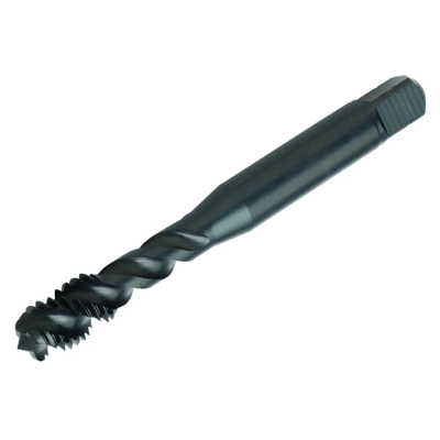

Thread size(TDZ)info
UNC #8-32Search Icon
Thread form(THFT)info
UNC 60°Search Icon
Tap chamfer length(TCL)info
1.4559 mmSearch Icon
Threads per inch(TPI)info
32Search Icon
Thread diameter(TD)info
4.1656 mmSearch Icon
Premachined hole diameter(PHD)info
3.5 mmSearch Icon
blind holeSearch Icon
Hole type(HTY)info
Tolerance class tool(TCT)info
H2 = Basic Plus 0.0005" to Plus 0.0010"Search Icon
Thread tolerance class(TCTR)info
3BSearch Icon
Shank standard group(BSG)info
ANSISearch Icon
Usable length (LU)info
16.576 mmSearch Icon
Tap shank ANSI -inch: 0.168 x 0.131Search Icon
Chip breaker(CBMD)info
MMSearch Icon
Grade (GRADE)info
T3P4Search Icon
Substrate(SUBSTRATE)info
HSS-PMSearch Icon
Coating(COATING)info
PVD FeNSearch Icon
Coolant entry style(CNSC)info
Coolant exit style(CXSC)info
no coolant exitSearch Icon
Connection diameter machine side(DCONMS)info
4.2672 mmSearch Icon
Connection diameter tolerance(TCDCON)info
h9Search Icon
Functional length(LF)info
53.975 mmSearch Icon
Neck diameter(DN)info
2.97 mmSearch Icon
Flute count(NOF)info
3Search Icon
Flute helix angle(FHA)info
48 °Search Icon
Radial rake angle(GAMF)info
13 °Search Icon
Threading length(THL)info
7.9 mmSearch Icon
Threading chamfer type(THCHT)info
C = 2-3xTPSearch Icon
Weight of item(WT)info
0.0074 kgSearch Icon
Overall length(OAL)info
