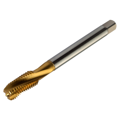

Being replaced by T300-XM101DA-M12 B125
Fully exchangeable with the original product.
ISO: E263M12file_copy
Material Id: 6181432file_copy
EAN: 26181432file_copy
ANSI: E263M12file_copy
PNSSearch Icon
Thread size(TDZ)info
M 12Search Icon
Thread form(THFT)info
M (Metric 60°)Search Icon
Tap chamfer length(TCL)info
3.8667 mmSearch Icon
Thread pitch(TP)info
1.75 mmSearch Icon
Thread diameter(TD)info
12 mmSearch Icon
Premachined hole diameter(PHD)info
10.2 mmSearch Icon
blind holeSearch Icon
Hole type(HTY)info
Thread tolerance class(TCTR)info
6HSearch Icon
Shank standard group(BSG)info
DIN 376Search Icon
Usable length (LU)info
83 mmSearch Icon
Tap shank DIN -metric: 9.00 x 7.00Search Icon
Chip breaker(CBMD)info
XMSearch Icon
Grade (GRADE)info
S9G2Search Icon
Substrate(SUBSTRATE)info
HSS-ESearch Icon
Coating(COATING)info
PVD TiNSearch Icon
Coolant entry style(CNSC)info
Coolant exit style(CXSC)info
no coolant exitSearch Icon
Connection diameter machine side(DCONMS)info
9 mmSearch Icon
Connection diameter tolerance(TCDCON)info
h9Search Icon
Functional length(LF)info
110 mmSearch Icon
Neck diameter(DN)info
8.7 mmSearch Icon
Flute count(NOF)info
3Search Icon
Flute helix angle(FHA)info
15 °Search Icon
Radial rake angle(GAMF)info
12 °Search Icon
Threading length(THL)info
23 mmSearch Icon
Threading chamfer type(THCHT)info
C = 2-3xTPSearch Icon
Weight of item(WT)info
0.06 kgSearch Icon
Overall length(OAL)info
112.1 mmSearch Icon
