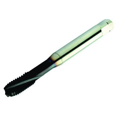

CoroTap® 300, cutting tap with spiral flutes
Being replaced by
T300-PD101AF-3/4 D110
Available within a week
Fully exchangeable with the original product.
Made-to-order
ISO: E8853/4
Material Id: 6182278
EAN: 26182278
ANSI: E8853/4
Thread size
(TDZ)
UNF 3/4-16
Thread form
(THFT)
UNF 60°
Tap chamfer length
(TCL)
4.282 mm
Threads per inch
(TPI)
16
Thread diameter
(TD)
19.05 mm
Premachined hole diameter
(PHD)
17.5 mm
Premachined hole type
(PHT)
blind hole
Hole type
(HTY)
blind hole
Thread tolerance class
(TCTR)
2B
Shank standard group
(BSG)
DIN/ANSI
Usable length
77.5 mm
Tap shank ANSI -inch: 0.590 x 0.442
Chip breaker
PM
T4J8
HSS-E-PM
PVD TiAlN
Coolant exit style
14.986 mm
Connection diameter tolerance
(TCDCON)
h9
125 mm
Neck diameter
(DN)
14.6 mm
Flute count
(NOF)
Flute helix angle
(FHA)
15 °
Radial rake angle
(GAMF)
5 °
Threading length
(THL)
30 mm
Threading chamfer type
(THCHT)
C = 2-3xTP
0.166 kg
125 mm
