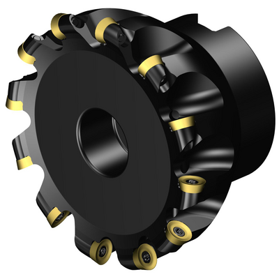

CoroMill® 300 face milling cutter
Specific representation
ISO: R300-080Q27-08H
Material Id: 5744437
EAN: 11881402
ANSI: R300-080Q27-08H
Cutting diameter
72 mm
Maximum cutting diameter
(DCX)
80 mm
Cutting item count
(CICT_2)
12
Clamping type code
Part 2 of cutting item interface identifiers
(CUTINT_MASTER_2)
CoroMill 300 -size 0828 (R300-0828)
Depth of cut maximum
(APMX_EFW)
6 mm
(APMX_FFW)
4 mm
Maximum ramping angle
1 °
Maximum plunge depth
(AZ)
1.9 mm
(ZEFP)
12
Arbor -ISO 6462 -A (hexagon socket head cap screw) -metric: 27
Coolant pressure
10 bar
27 mm
Standard number
(STDNO)
ISO6462
Standard letter
(STDLET)
A
50 mm
Radial rake angle
(GAMF)
7 °
Axial rake angle
(GAMP)
1.2 Nm
Body material
Steel
Rotational speed maximum
20,500 1/min
0.881 kg
50 mm
